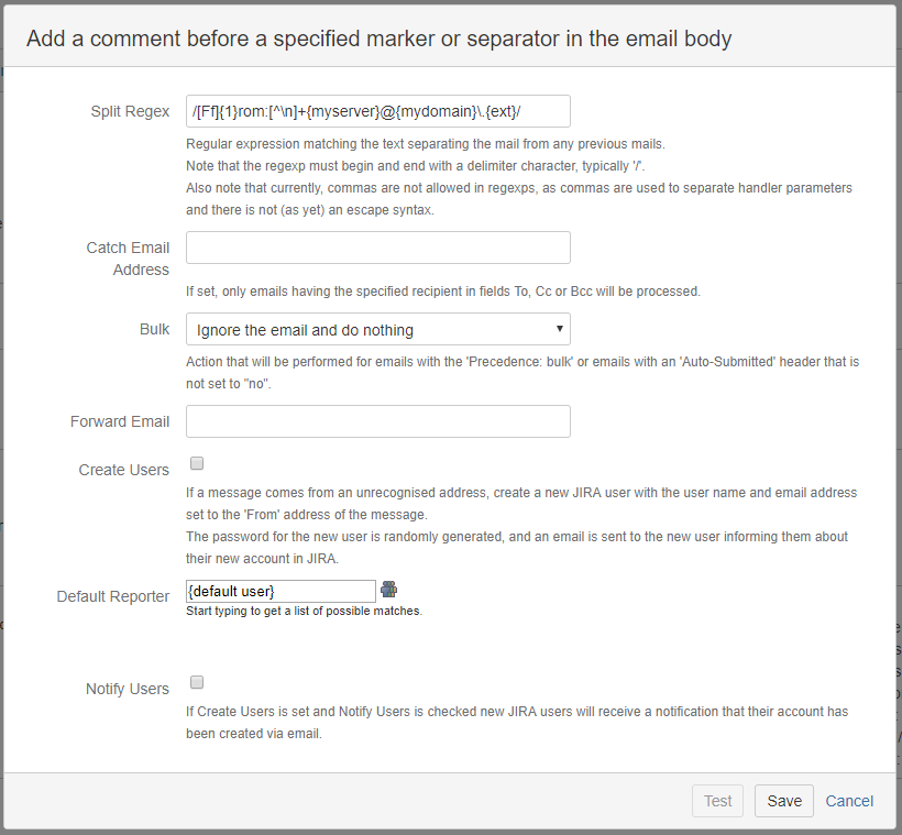

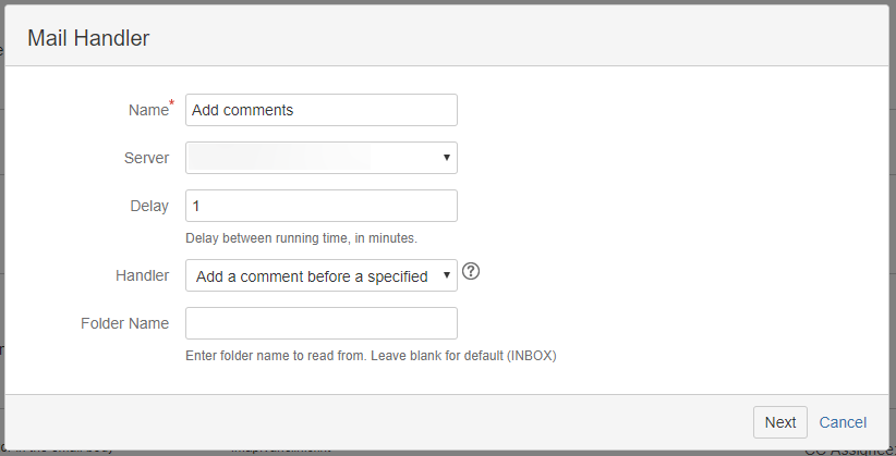

Recently, we started using Jira at work to track some IT related things. Thus, I have quickly had to learn how to administer Jira. One thing that I really wanted to get set up and working well was the ability to respond to an email sent by the system via a reply email and have that filed in the ticket. That wasn't too terribly hard to set up. First I created a mailbox for Jira to check in our mail system. Then I set up a mail handler to pull the reply emails in. I settled for using a "Add a comment before a specified marker or separator in the email body" handler so that I could provide a regular expression to define how to extract just the reply. The below screenshots show my setup for this.
The Split Regex field below is this /[Ff]{1}rom:[^\n]+{myuser}@{mydomain}\.{extention}/. Replace the {myuser}, {mydomain}, and {extention} parts with the email address of the account that Jira mails as. So, if your Jira system sends email as jira@coolstuff.org the above expressions would look like this /[Ff]{1}rom:[^\n]+jira@coolstuff\.org/. This will split the email where it sees the first line that looks something like this From: Jira [mailto:jira@coolstuff.org] or from: Jira [mailto:jira@coolstuff.org] ... which is how Outlook formats its replies.

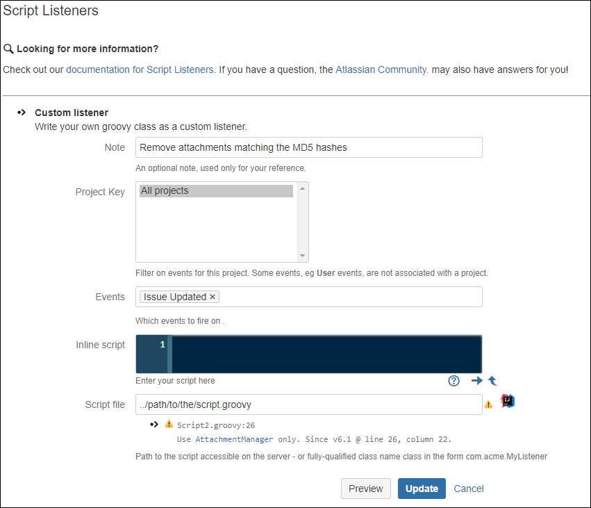

After a bit of thinking I decided I could just scan the images against a set of MD5 hashes to exclude when the issue is updated and here is the fruit of my labor. This solution requires having ScriptRunner for Jira installed. It's a pretty slick add-on for Jira that has endless possibilities as to what can be done with it. I created a Script Listener that would respond to the "Issue Updated" event.
And the actual contents of the script file.

}Now, when I respond to an issue via email if any of the attachments on the issue match any of the MD5 hashes at the top of the script that attachment will get deleted from the issue. And if I find that there are other attachments we start seeing like this on a regular basis all I have to do is add the MD5 hash to the list and save the script ... problem solved.
