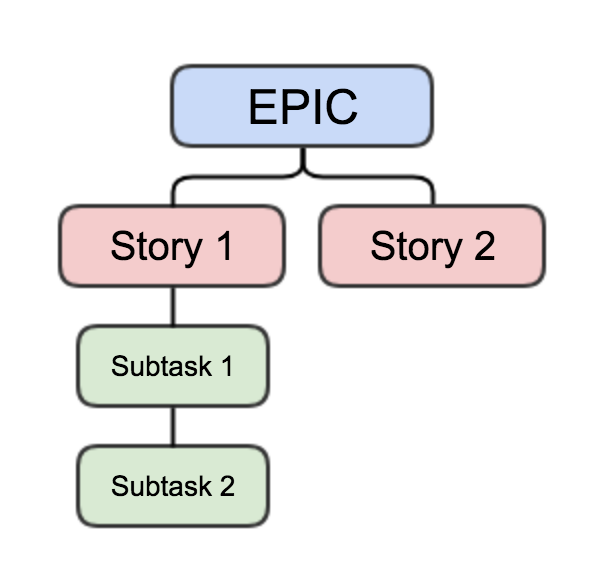

Alternatively stated, an epic can contain stories and stories can contain subtasks. So, hierarchically, imagine the overall relationship like this.

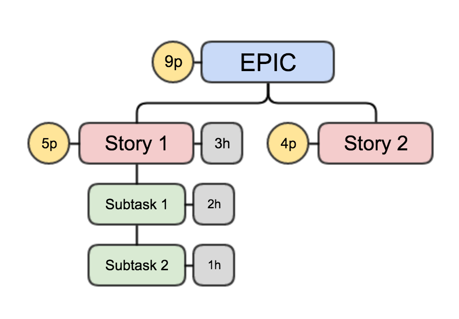

Time tracking in Jira, on the other hand, is a burndown of hours that will allow you to monitor progress against a unit of work. Tracking will typically possess a different value than estimation, i.e. you might estimate in story points but track in hours. One thing to note: in the case of tracking, you can establish original time estimates at the subtask level, the value of which will sum up into a parent story. However, tracking values will not roll up into epics.
For clarity's sake, here is the above diagram, again, with estimation in yellow and tracking in grey.
So, when you decide upon an estimation and tracking system, consider the above behaviors. What estimation and tracking statistics will you use? Do you want to track time or will you trust that work should be complete by cycle's end? While you're free to choose your own estimation and tracking statistics, separate statistics are preferable to make sure you aren't conflating the two metrics.
