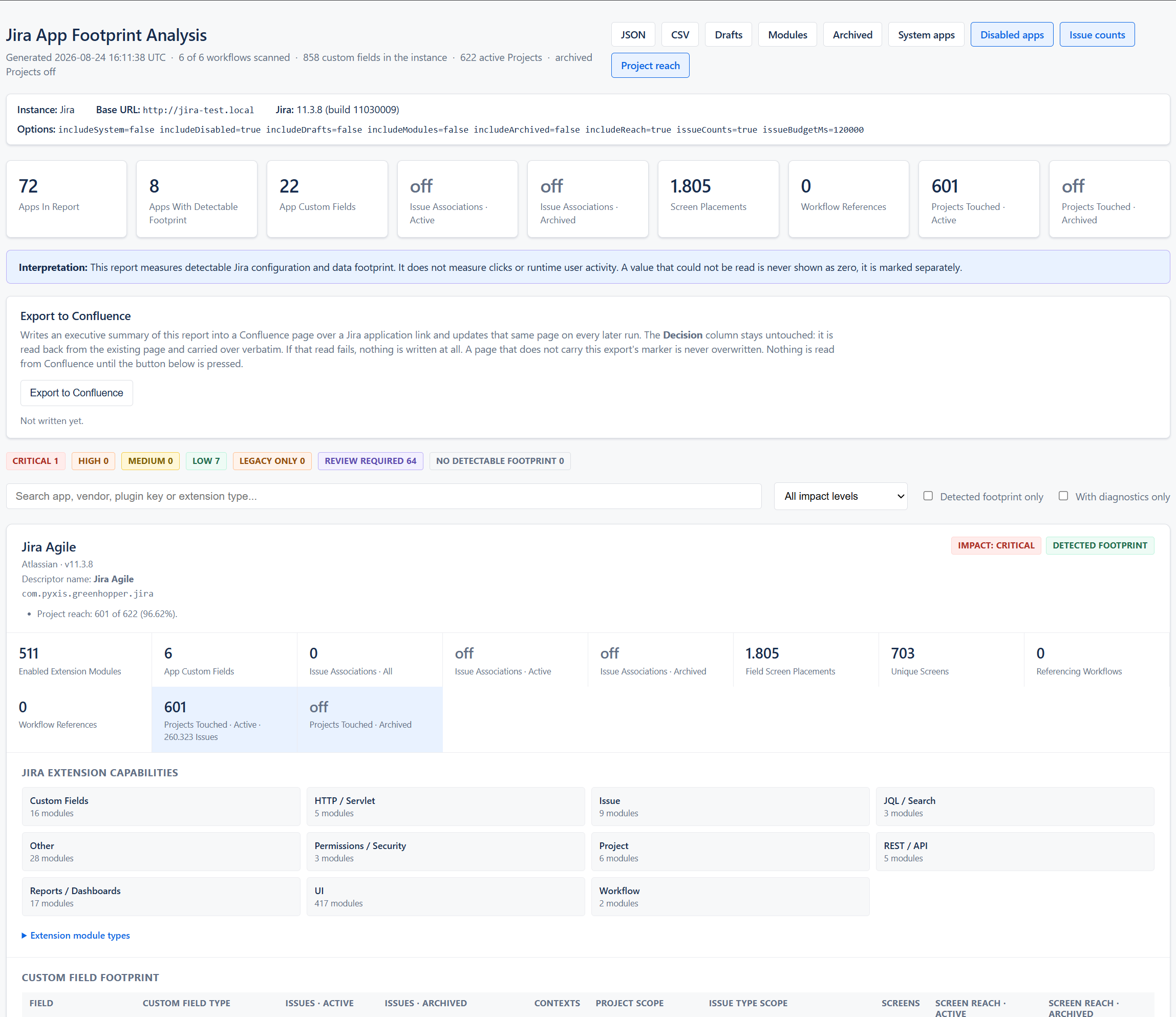

I ended up building some ScriptRunner-based tooling around this and eventually turned it into an open-source repo:
Atlassian Data Center App Footprint
It currently covers Jira Data Center and Confluence Data Center.
For Jira it looks at things like app-provided custom fields, whether those fields actually contain data, contexts, screens, workflows and the projects/issues reached through that configuration.

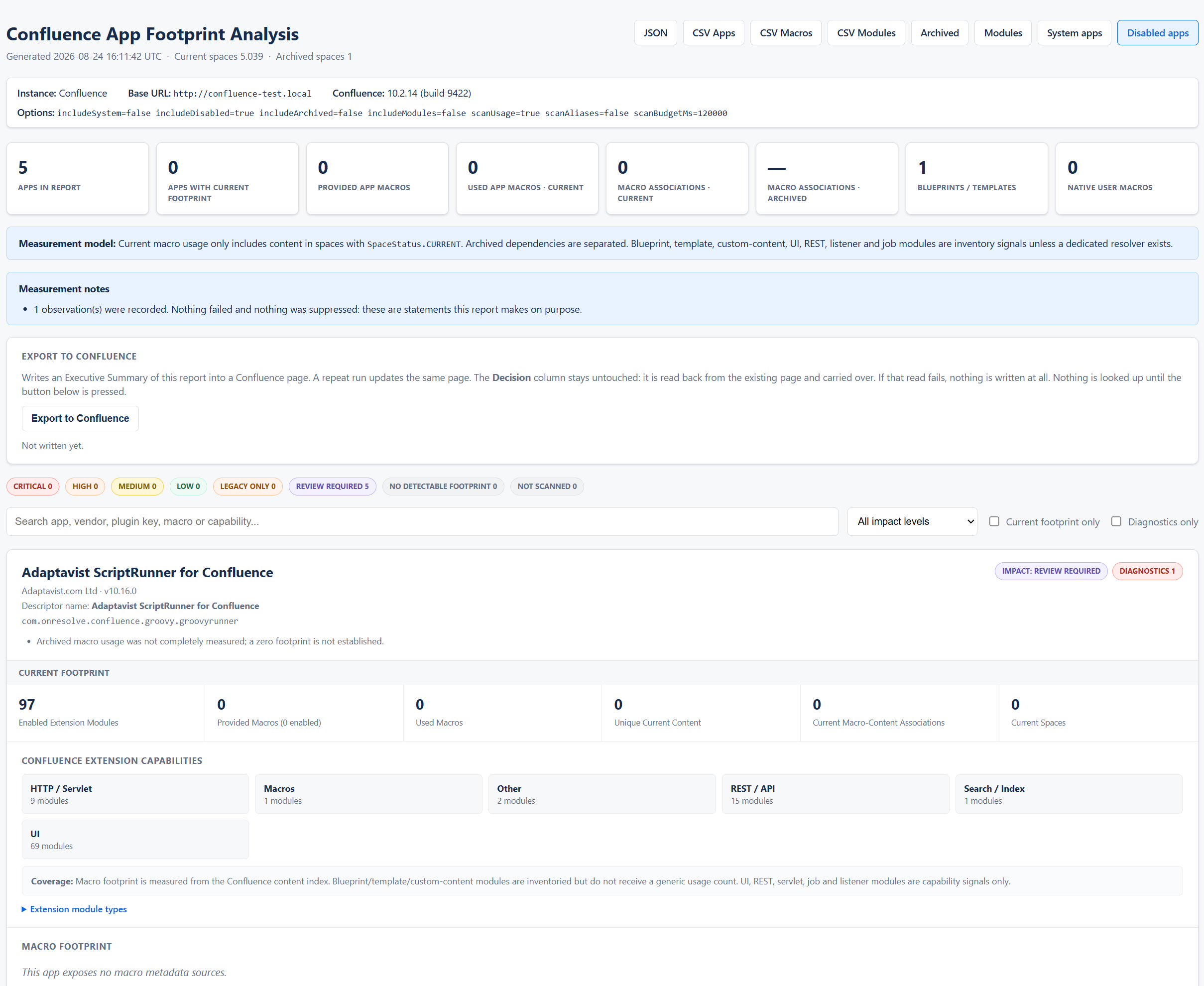

For Confluence it looks at app-provided macros and modules, actual macro occurrences in content, affected spaces and also keeps native User Macros separate from Marketplace apps.
Archived data is handled separately as well. This turned out to be important in practice. An app can look quite heavily used until you realise that most of its footprint is sitting in archived projects or spaces.
The report is available as HTML, JSON and CSV, but one feature we've found particularly useful during an actual migration is the Confluence page export.

I was also quite careful about incomplete measurements.
Some scans can get expensive on larger instances, so there are configurable time budgets. If something could not be measured, the result says NOT MEASURED rather than quietly turning that into a nice-looking 0.
The same idea applies to the Confluence export. If the existing page cannot be read reliably, the script doesn't overwrite it with an empty Decision column. It stops instead.
