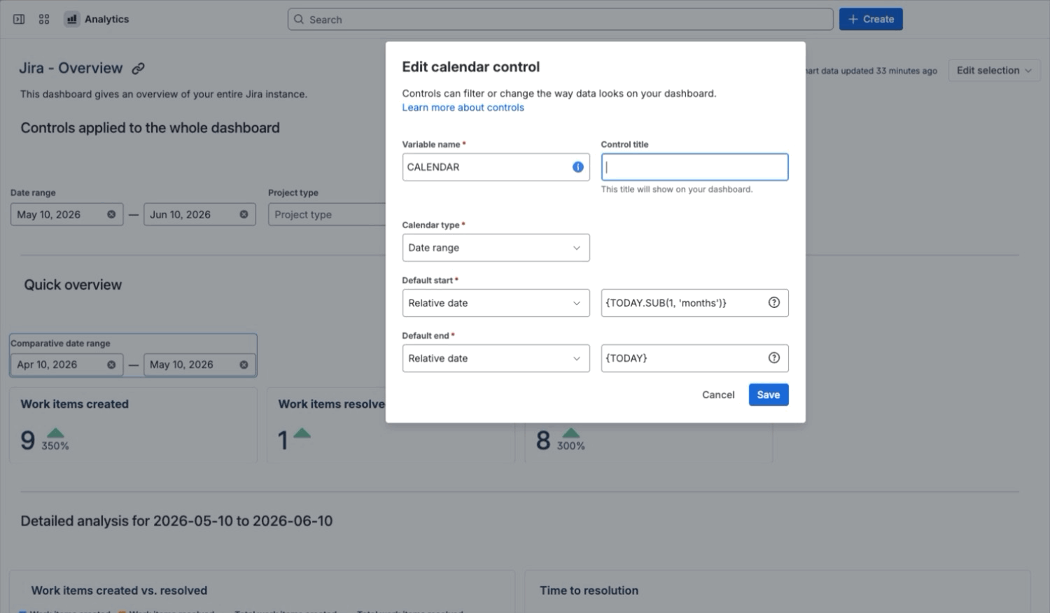

Select Control > Calendar from the dashboard sidebar.
Optionally, add a title to your control.
For Calendar type, select Date range.
Edit the Default start and end dates using fixed dates, or use a combination of relative date variables and date and time functions for dynamic filtering.
Select Add, then place the control anywhere on your dashboard.

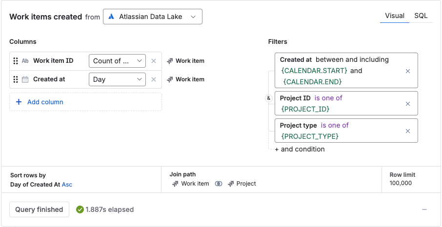

To connect your Calendar control to a chart using a visual mode query:
Open the chart editor by creating a new chart or editing an existing one.
In the Filters section of your visual mode query:
Add the date column you want the control to filter.
Select the filter operator (most people use between and including).
Reference your control using its dashboard variable name:
If the "Data type" is Date, use {CALENDAR_NAME}
If the "Data type" is Date range, use {CALENDAR_NAME.START} and {CALENDAR_NAME.END}
Replace CALENDAR_NAME with the dashboard variable name of your control.
Select Run query, then Save to dashboard.

Hover over the chart and select More actions > Edit chart.
In the Filters section, add your date column and select between and including as the operator.
Use {CALENDAR_NAME.START} and {CALENDAR_NAME.END} to reference your Calendar control.
