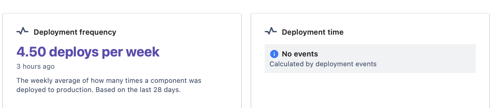

We have some repos linked to GitHub and some require using the REST api to post our build events. The GitHub linked show a Deployment Time metric, but the custom one does not. I assume it's some bug in the way I'm posting my deployment events via the REST api. I post a PENDING event with an updateSequenceNumber, then at the end I post a SUCCESSFUL event with a higher updateSequenceNumber and a a later lastUpdated date. deploymentProperties.sequenceNumber stays the same both posts.
When looking at the timeline in Compass, I first see the pending event in the timeline, then when done, it's turned into a complete checkmark. So it seems the 2 events are being associated with each other correctly? But the Deployment time metrics show now events as you can see in the screen shot. Appreciate the help!!
