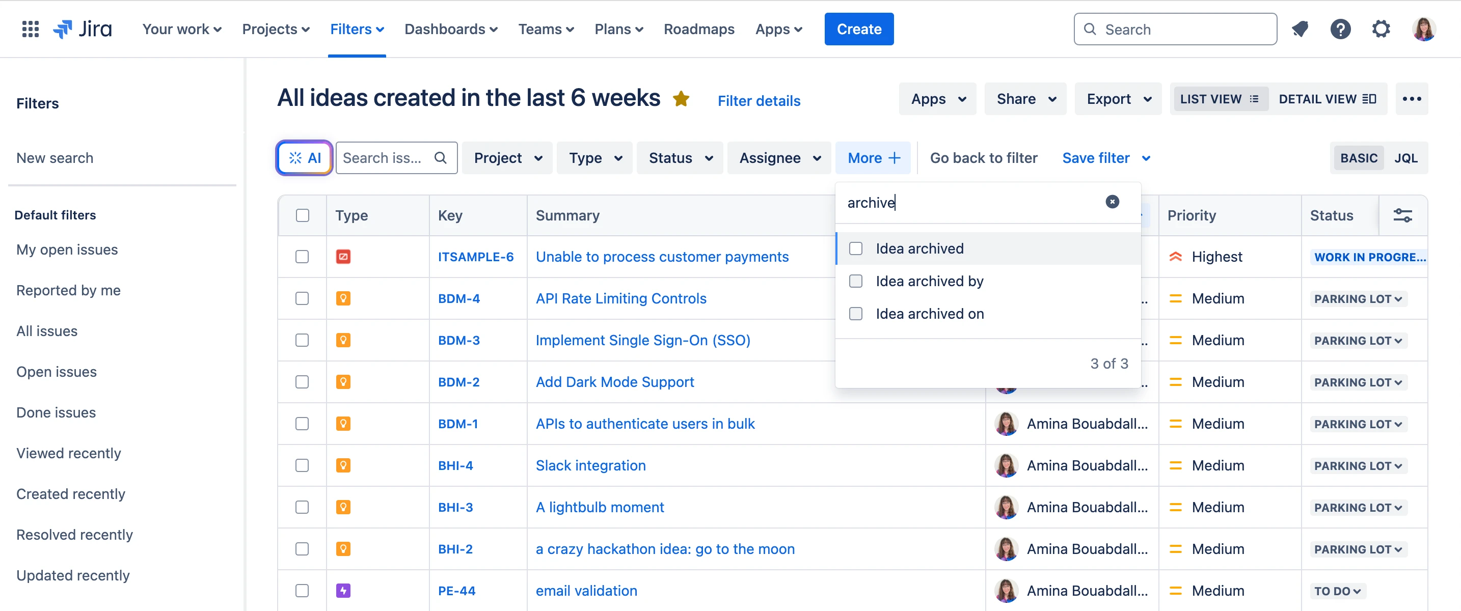

Amongst the set of JPD system fields, we have 3 fields related to the archiving capability, called archiving fields, that we are making global:
Idea archived: flag to denote that an idea is archived
Idea archived by: user who archived the idea
Idea archived on: date when an idea was archived

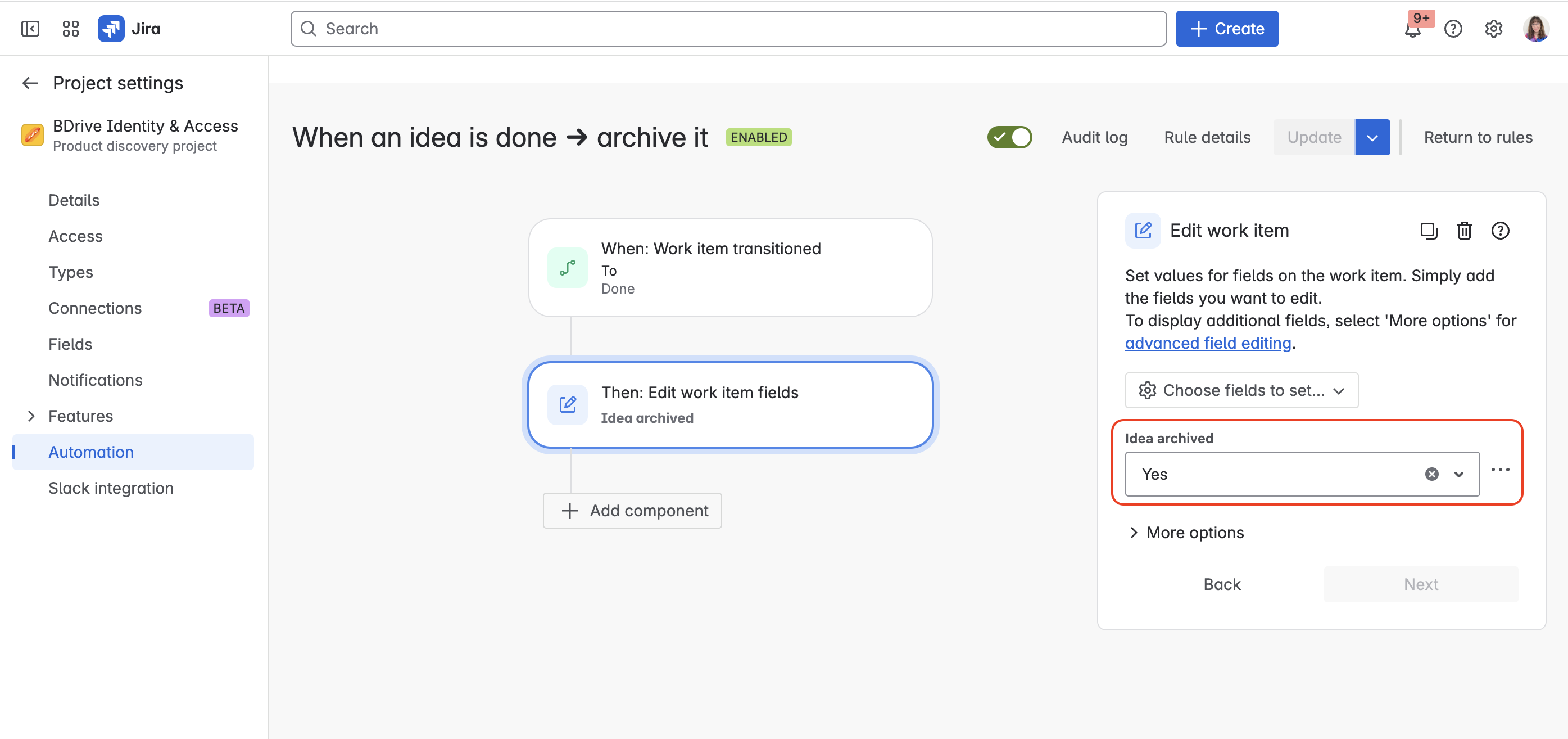

Some of you are using these fields in your automations today, to automatically archive ideas that are done for example, as depicted below.
This automation rule sets the Idea Archived field to Yes on DONE ideas.

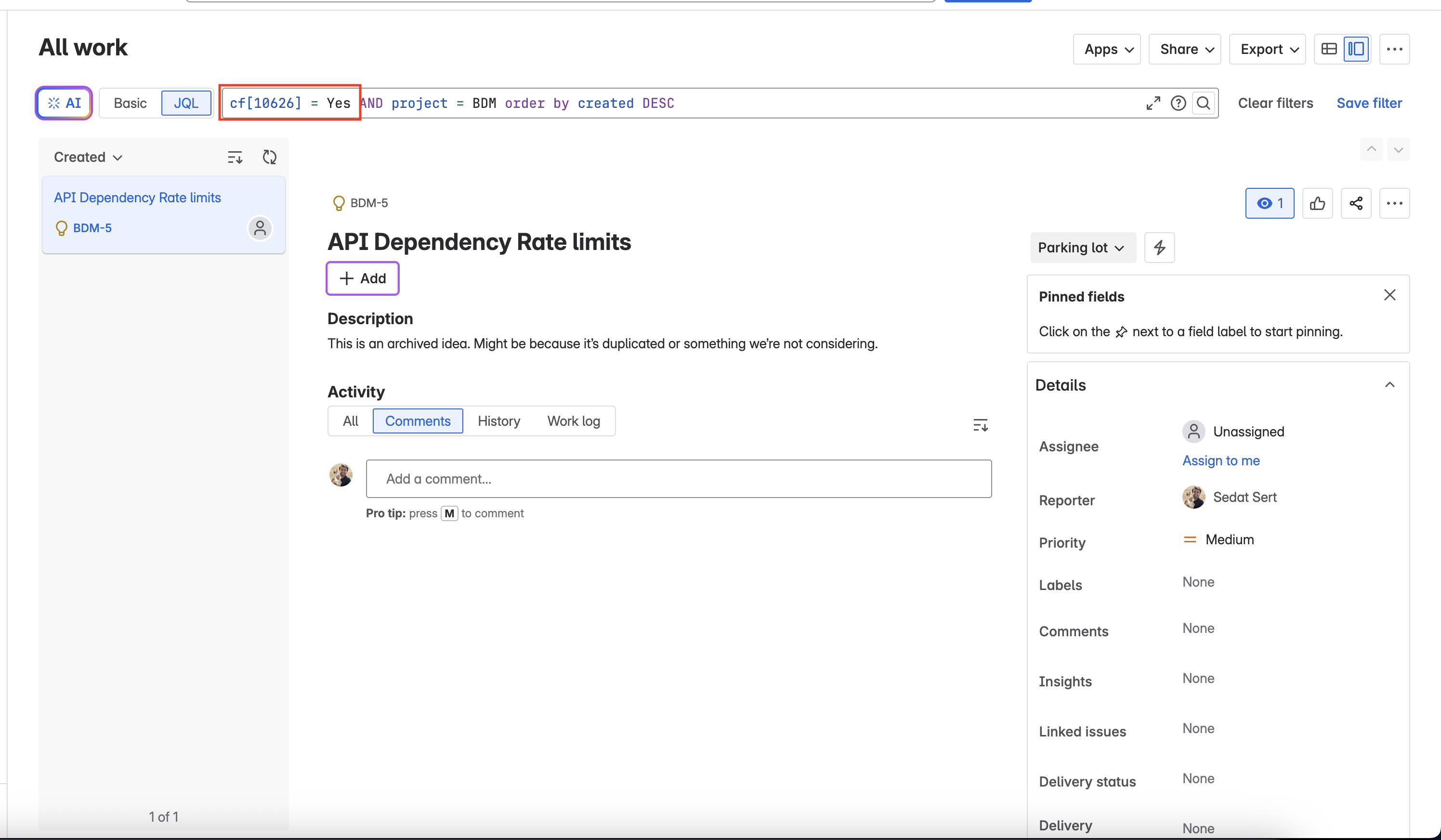

JQL and Jira filters using archiving fields via their field id

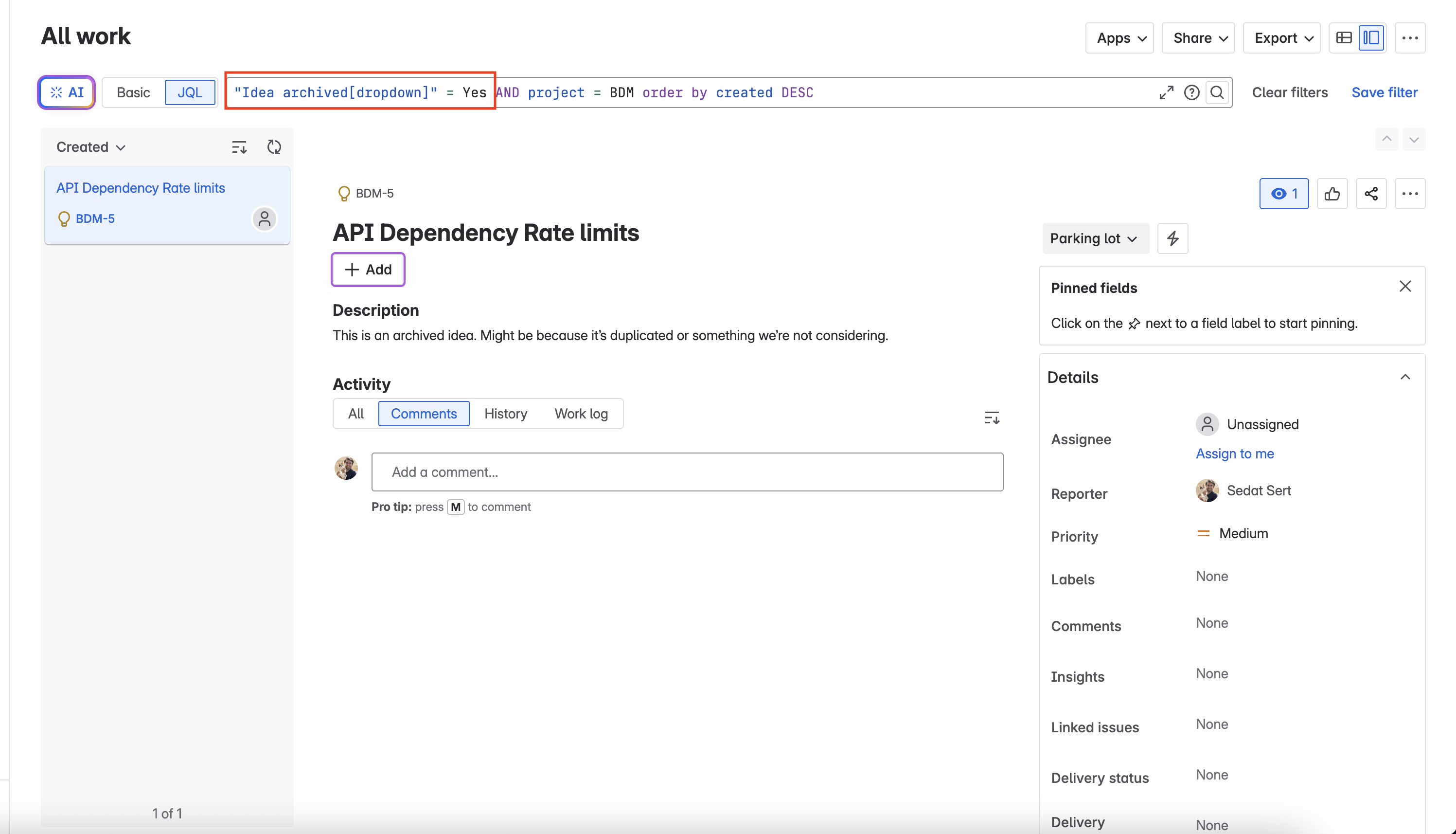

If you are using archiving fields in any JQL query or Jira filters via their field id, you will need to update them to use the global system field via their name instead.
Example below uses the Idea archived field id.
In the example below, we use the name instead. If you see ideas from other projects, this is expected as you will need to add a project condition such as project = BDM as shown in the screenshot.

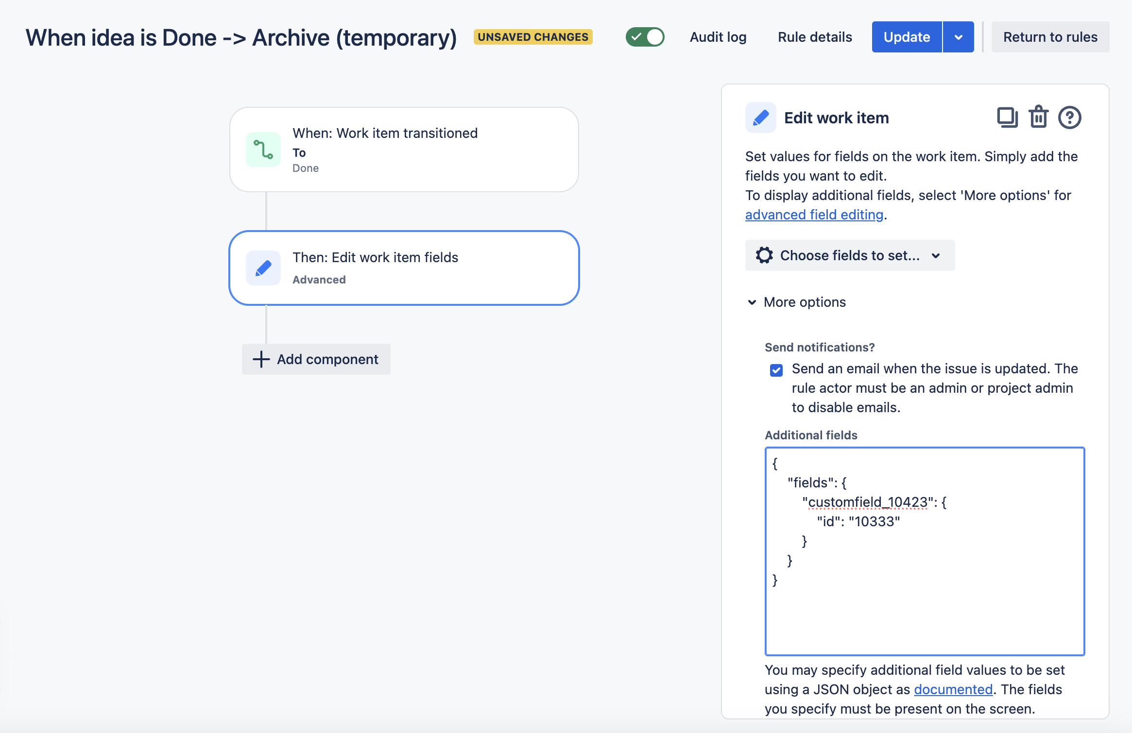

Project field
"fields": {
"customfield_10423": {
"id": "10333"
This shows the existing archiving fields in the JPD project added in the URL.

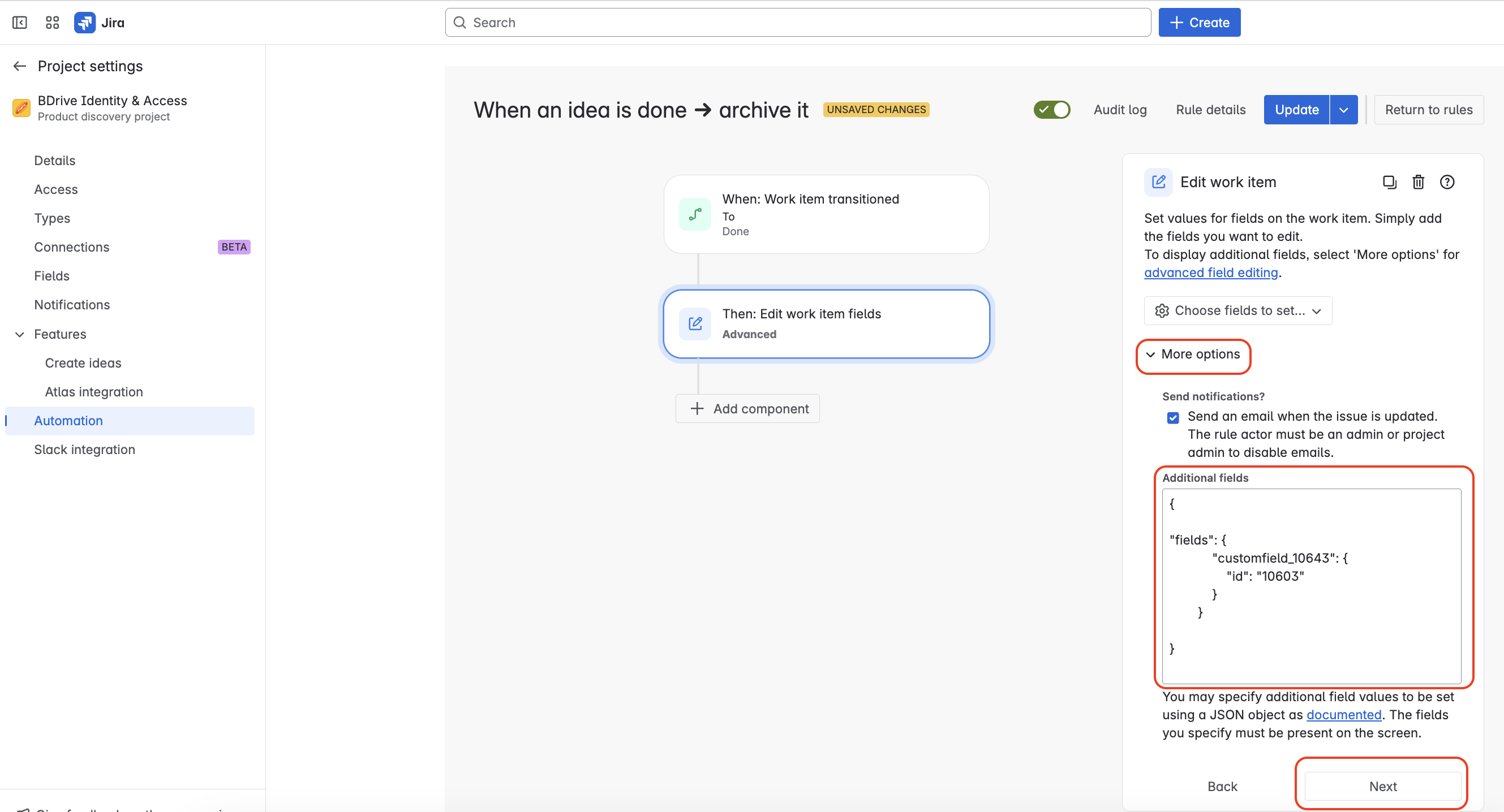

In the second part of the output, you will notice JSON for your “Idea archived” field which you can copy paste into your automation action.
In the example above, the global Idea Archived field is called customfield_10643. The identifier is set to “10603”: it means the Idea Archived global field is set to “Yes”.
Copy the “Global field” JSON object
Go back to the automation rule builder
Expand “More options”
Paste the JSON object into Additional Fields
Hit Next and Update the rule
The action in your automation rule now sets the global Idea Archived field to “yes” instead of the project-level Idea Archived field.
