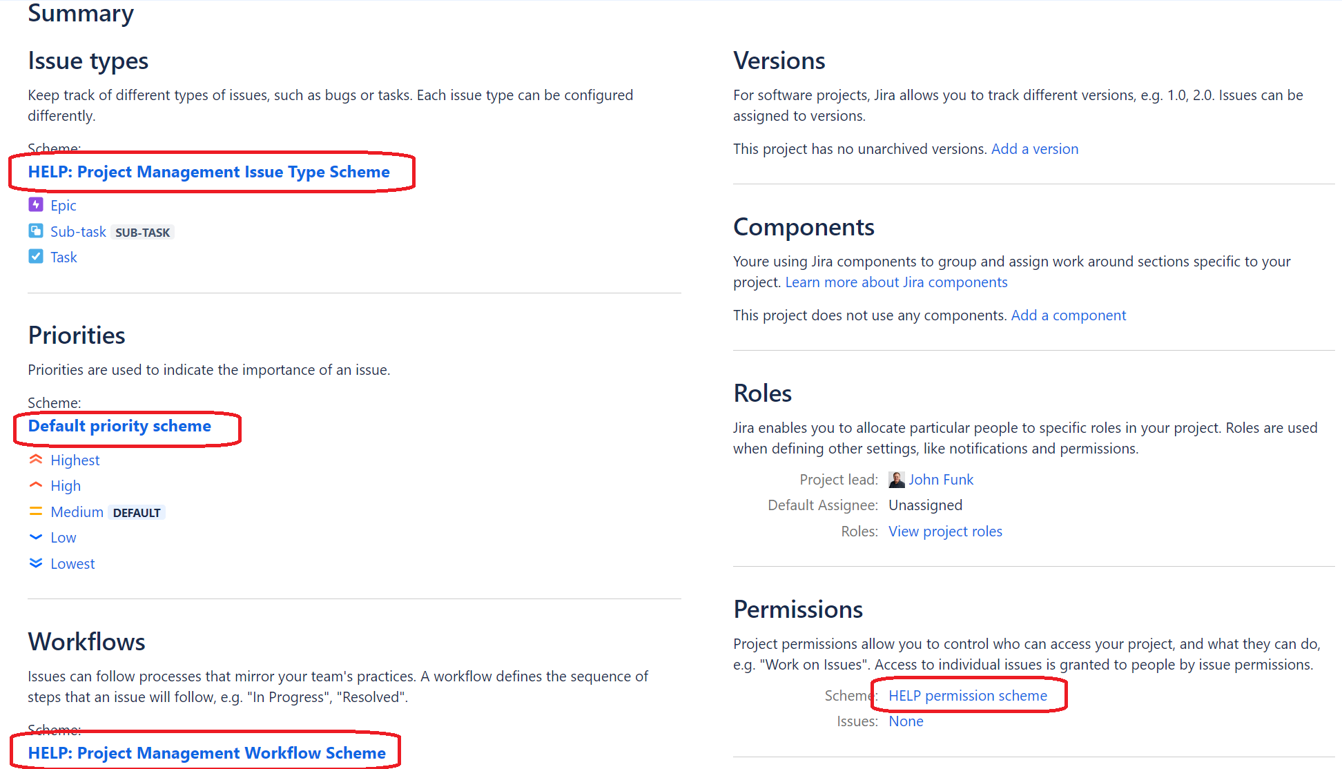

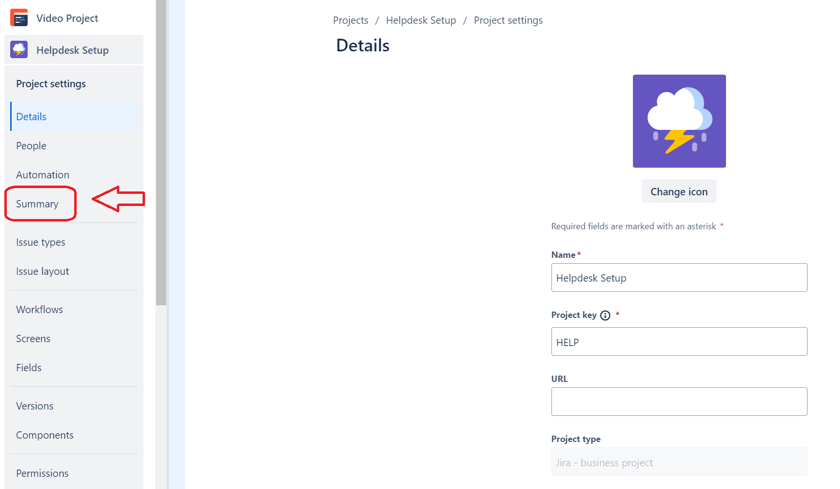

While on a project, click on Project Settings. You most likely will land on the Project Details page. At this point, you could click on the appropriate related link on the left-hand menu, such as Permissions; however, I like to go directly to the Summary view in the project settings.
The reason I like to start here for almost all of my project configurations is because many schemes are available in one view.

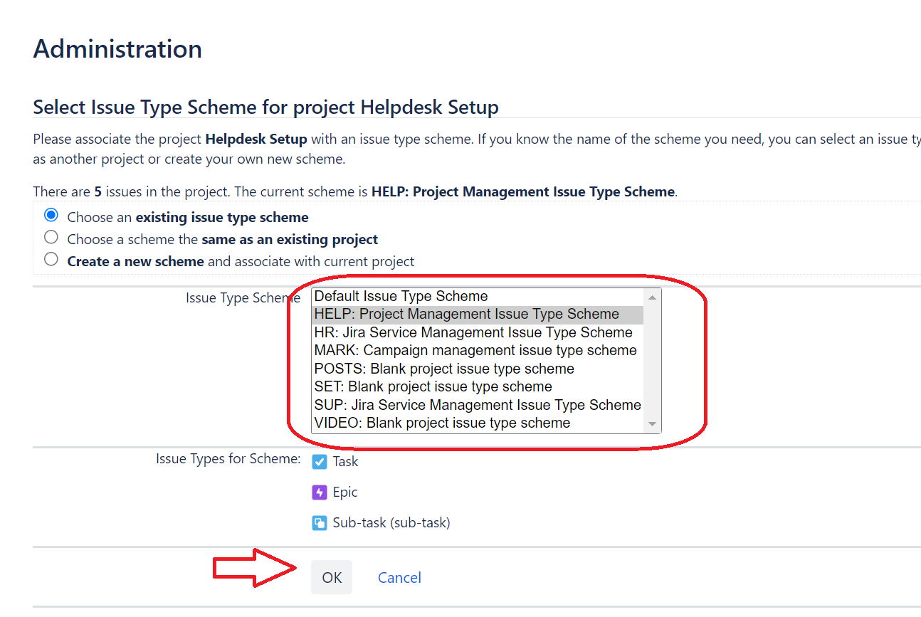

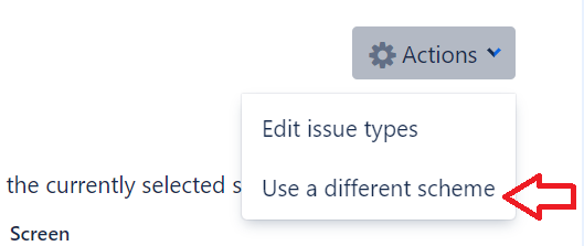

To make a change, simply click on the name of the Scheme. For this first example, we will use the Issue Type Scheme. Clicking on the scheme name will show detailed information about the scheme. Click on the Actions menu on the upper right and select Use a different scheme.
On the following screen, select a new scheme from the dropdown (they should be in alphabetical order) and then click OK.
For the most part, all schemes except the Workflow Scheme will follow this same pattern. You will be done with the switch for most schemes at this point.

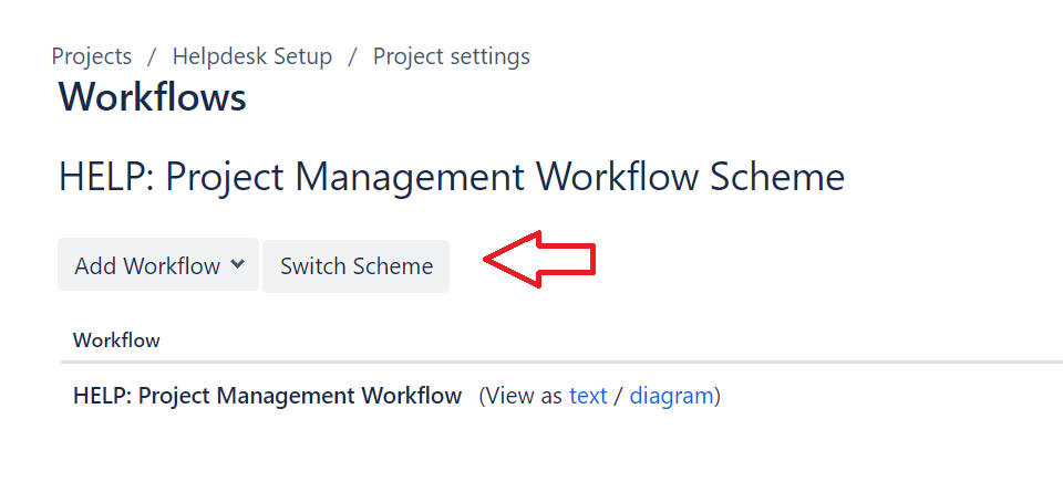

To change the Workflow Scheme, click on the name of the workflow as above. Making the change is much more obvious here as you just need to click the Switch Scheme button.
Like the Issue Type Scheme, if your new Workflow Scheme contains workflows that have different Statuses than the previous workflows, the system will walk you through the migration process from the old statuses to the new statues.
