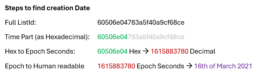

Say, you know a list has ID: 60506e04783a5f40a9cf68ce (More later how you get that ID in the first place)
The first 8 digits of this ID are actually the Date, but not in a normal Human Format but instead hexadecimal = 60506e04... Yes, nerdy, but an online like https://www.convzone.com/hex-to-decimal/ can turn it into a "normal" decimal number and we get the value: 1615883780... ??!??
That does not look like a Date, and yet it is... This is actually the number of seconds since the 1st of January 1970; I warned you; developers are nerdy :-)
Fear not: another online converter: https://www.epochconverter.com/ can make this into a human date, and our final result: 16th of March 2021 @ 8:36:20 AM (UTC)

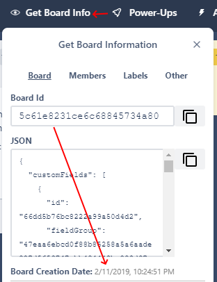

So above is the manual way to explain to you what going on (which is fascinating if you are a nerd like me)... But you can avoid all the work with; as always; a PowerUp:
The Developer ID Helper PowerUp and give you the IDs and some of the simple creation dates in the Process.

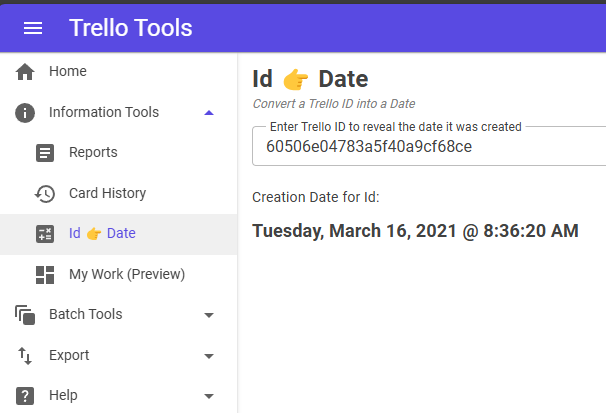

or if you have an ID that the PowerUp do not reveal the Date for you can skip all the above calculations with this handy TrelloID > Date Converter
https://trellotools.azurewebsites.net/IdToDate
