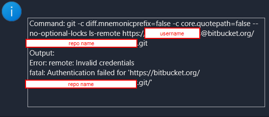

I am getting the following error when I try to clone.

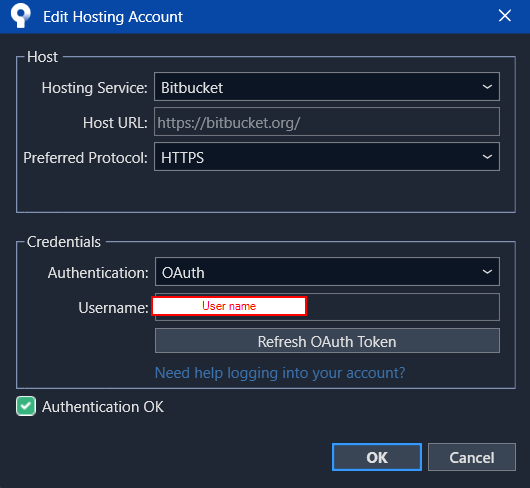

This is what else I have tried and see. Everything for my account validates on installation. It logs me in to Bitbucket through Sourcetree. When I get to the main screen (remote tab) I can see every repo under our company. When I edit user to see the credentials, I have "Authentication OK"
Everything looks perfect until I try to clone. Then I get "This is not a valid source path / URL" and the expanded error message above.
I know everything is set up right server side, as none of my coworkers have this problem, and my old computer does not have this problem, using OAuth with that popup that refreshes the key for you.
I have also tried changing to basic authorization with an App password according to a zillion answers online. It technically works and says "Authentication OK" and will still not clone. Please do not recommend this app password solution to me, it works fine with OAuth on other computers and with this one.

5. Poked around in every credential setting in SourceTree (Authentication OK)
