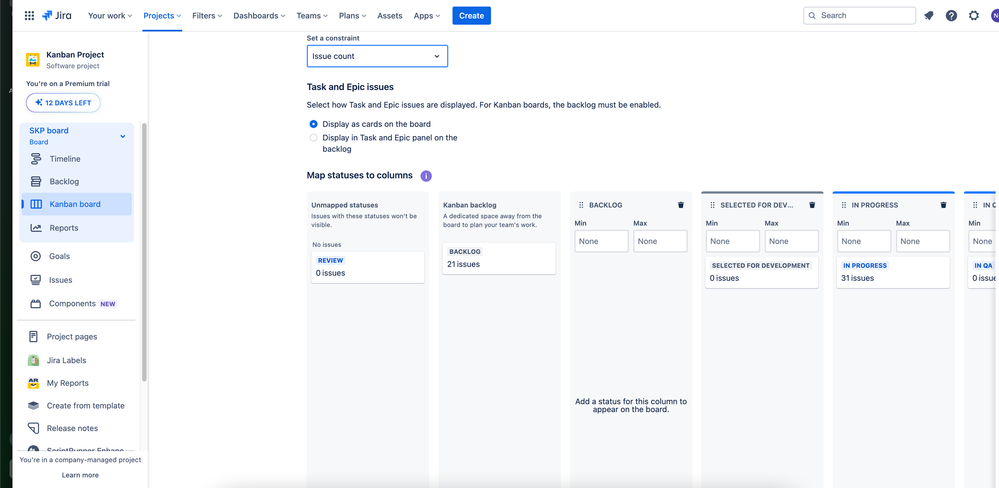

There isn't really a best practice for how much of issues should be in the In Progress status, however for a sample project that you create using kanban - this is created by Atlassian, they have set this max number to be 5 issues.
You do this:
Here, you can set both min and max number of issues.

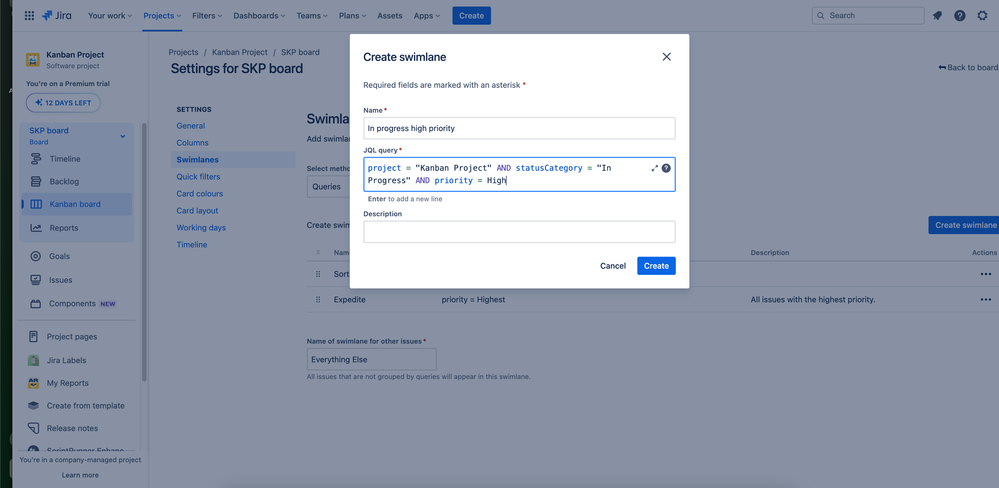

Now for the second question, swimlanes would solve this issue, because this divides your board in separate sections. For the requirement, you need to use the JQL, that would look like this:
statusCategory is being used because there could be other statuses that are in the In Progress status category.
If you are only using In Progress status, you can use status instead of statusCategory.
