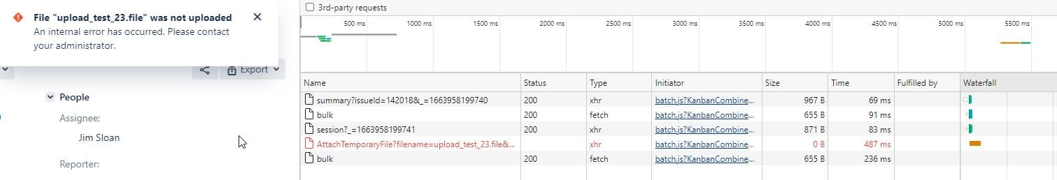

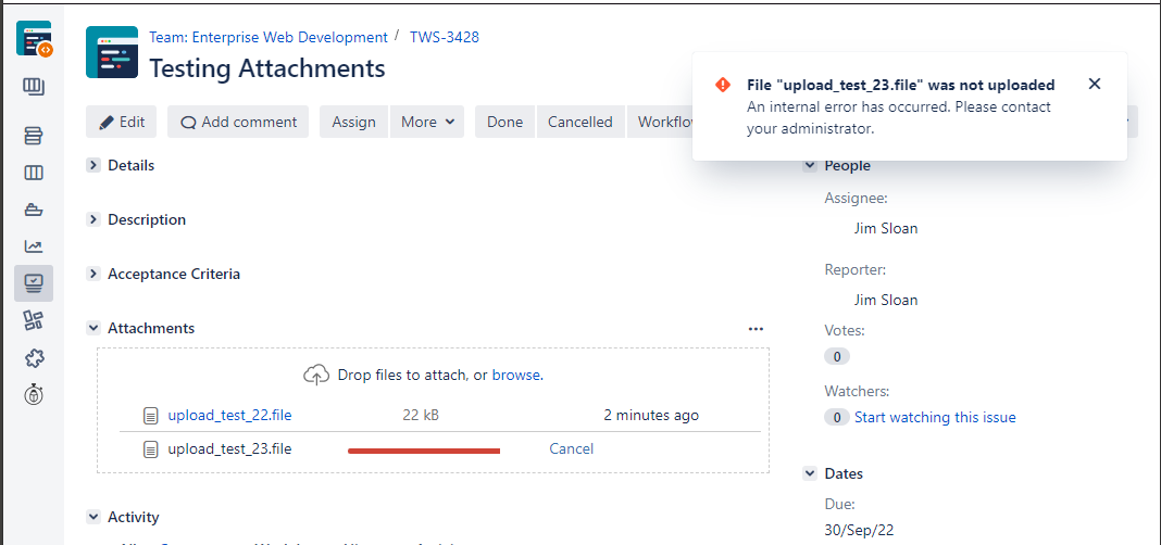

I have Jira v8.20.1 hosted on a Windows server. I am using Edge browser (but have the same result in Chrome) and have a problem attaching files using either drag or browse. I have success with any file of any type as long as it it 22k or smaller. But all uploads of files of 23K or larger fail. The pop up message is "File "upload_test_23.file" was not uploadedAn internal error has occurred. Please contact your administrator." There are no errors in the atlassian-jira.log. In fact when this occurs I I see no response from the server (using Edge Inspect Network).
The System Attachment Size = 47.68 MB.
Are there any other steps for troubleshooting?
