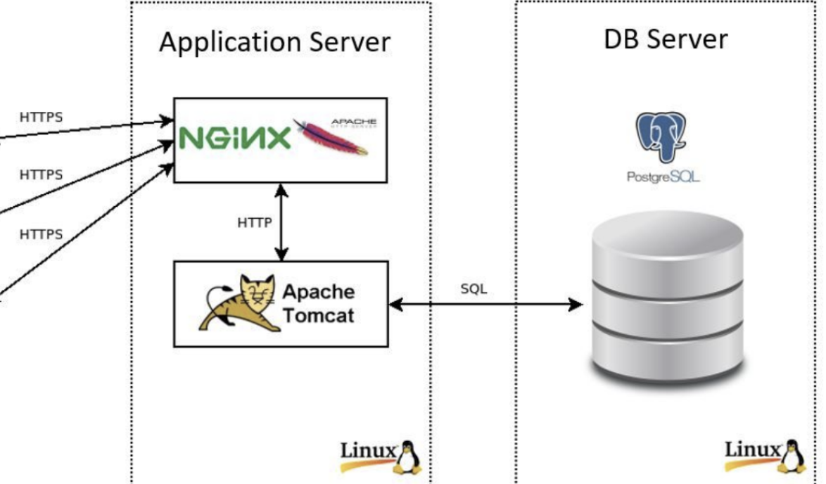

Today I would like to share a small story about the performance improvement of Confluence for one large company. They used that installation for more than 3.2k requests per minute based on the daily stats from frontend reverse proxy logs.
The architecture of that is quite simple based on the reverse proxy (nginx), Confluence app (tomcat), PostgreSQL as RDMS.
All those services work on CentOS 7.
