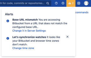

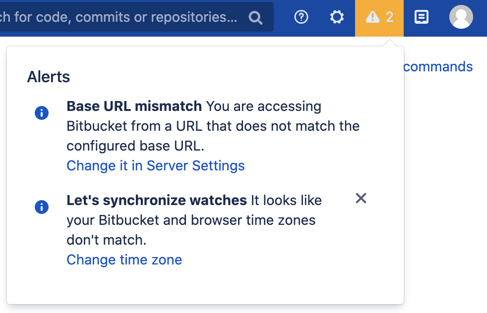

When browsing the site after it comes up, we get the warning that the Base URL is not set correctly:
When looking in the settings, the Base URL does match the URL I am accessing Bitbucket from. This suggests that it's the proxy settings that are not set up correctly. Alas, all I can do to check this is to look at the environment, which seems OK. Adding a bitbucket.properties file and having the settings in there (as we do in our legacy environment) has no effect.

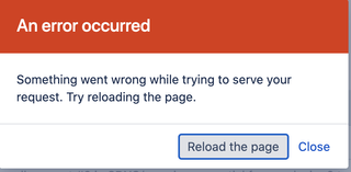

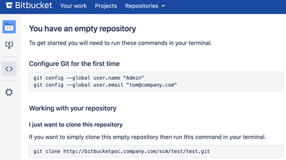

In addition, there are two other side-effects that I have noticed that I believe to be related.
Thanks,
