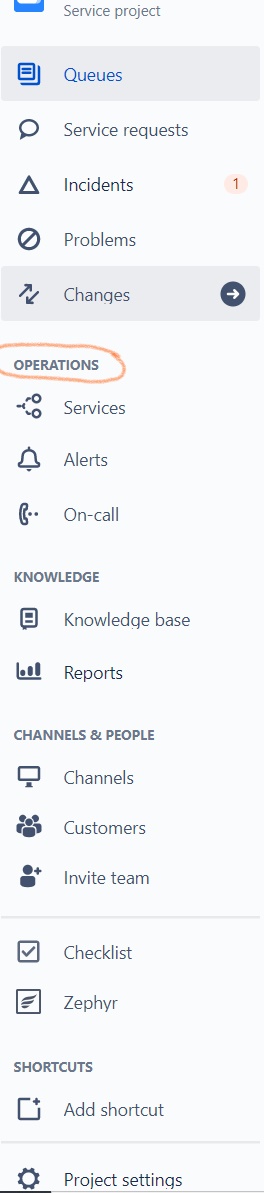

Current Setup: Our Opsgenie was initially enabled from JSM2 service project (commonly used for external stakeholders) leading to default options in Jira project under ‘Operations section – Refer Screenshot JSM2 default setting’. Upon clicking on these options, user gets directed to Opsgenie platform.

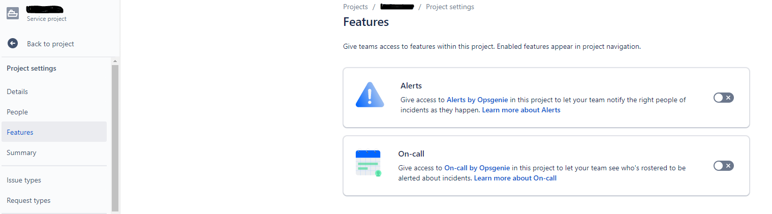

Opsgenie was later linked to JSM1 project (commonly used for internal issues) via webhooks per team for which there was a toggle option in Jira project under Project Settings > Features tab. (Please refer Screenshot JSM1 toggle option)
Due to this structure of integration, Opsgenie has incoming alerts from both the projects. Also, JSM2 project is receiving all incidents details that are being generated in Opsgenie rather than the specific ones. Nonetheless, JSM2 project doesn’t have an option to delete or remove these incident details. Is there a way to undo this and set up an Opsgenie environment as outlined below in the ideal situation?
