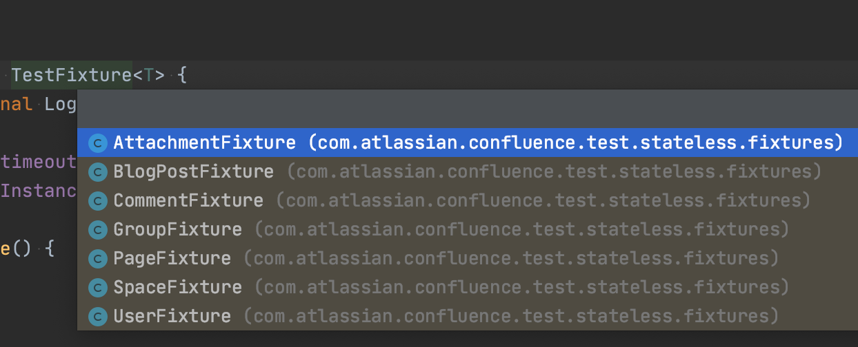

Note the usage of :
@Fixture which allows us to create all the data needed to orchestrate our test flow; these must be declared as static fields
@Inject which gives us access to services that allow us to navigate around Confluence and interact with its user interface

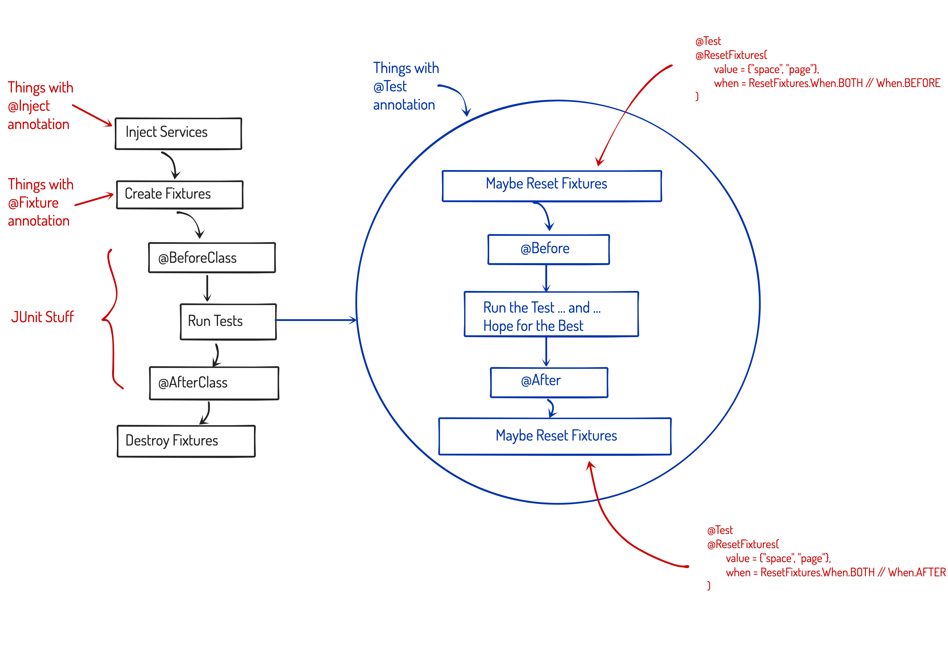

Without going into too much detail, this is how stateless test runner does its magic:

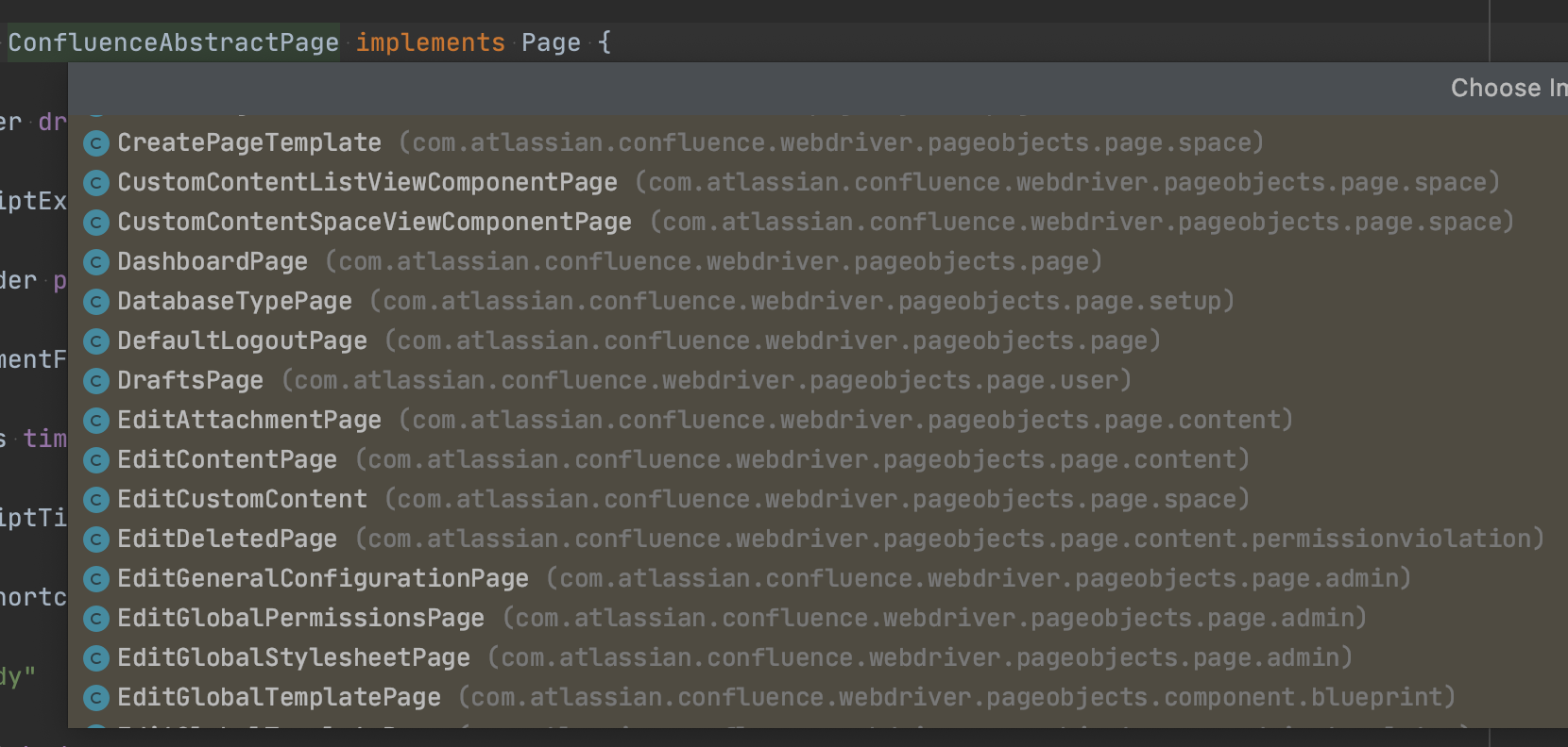

I would recommend discovering our Stateless and WebDriver PageObjects API by poking around your IDE a little; for instance, look up implementations of:
- com.atlassian.confluence.webdriver.pageobjects.page.ConfluenceAbstractPage to find out which UI components you can navigate to

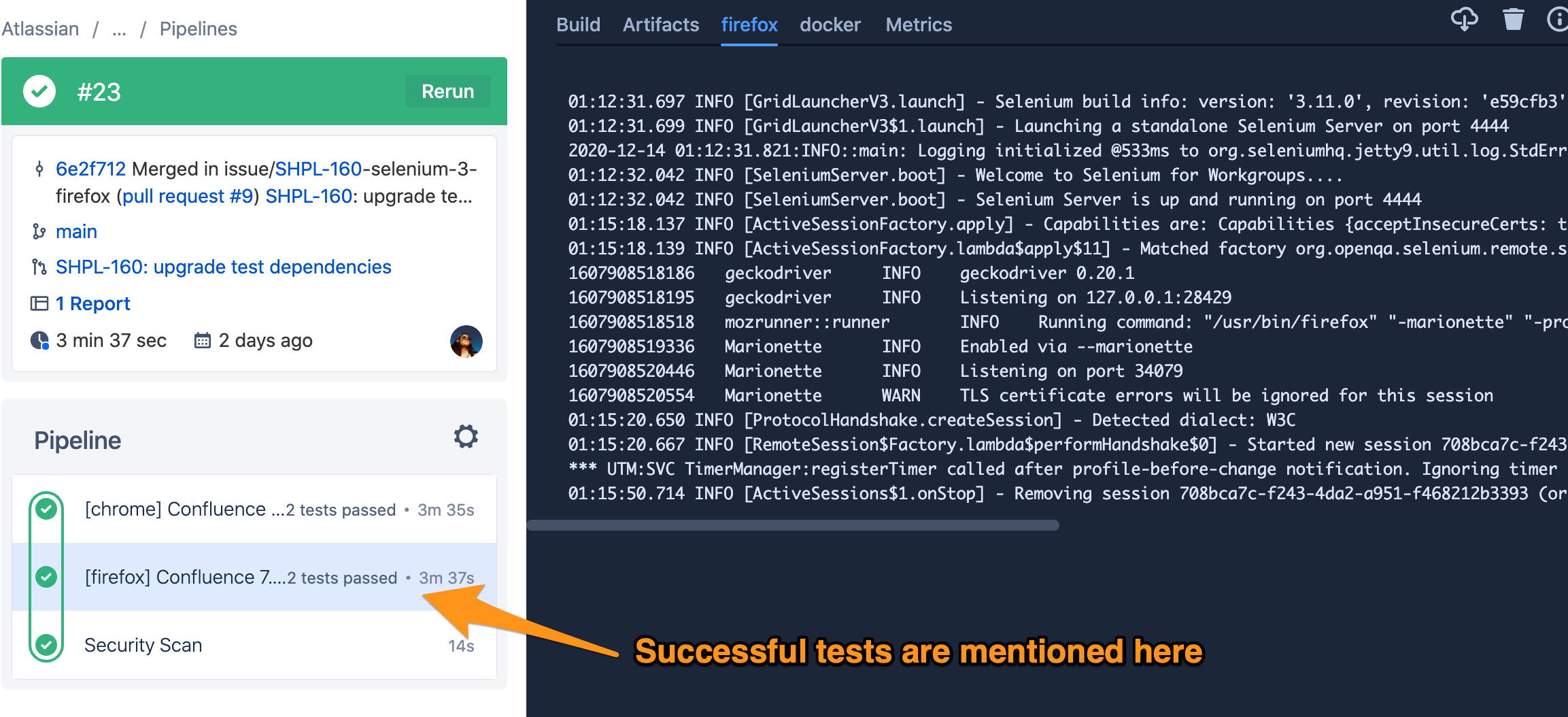

Now that we have our integration tests running, it would be nice to see them reported on the pipeline build results. According to test reporting in Bitbucket Pipelines , the Maven failsafe/surefire reports are expected to be available in one of the following directories:
./**/surefire-reports/**/*.xml
./**/failsafe-reports/**/*.xml
./**/test-results/**/*.xml
./**/test-reports/**/*.xml

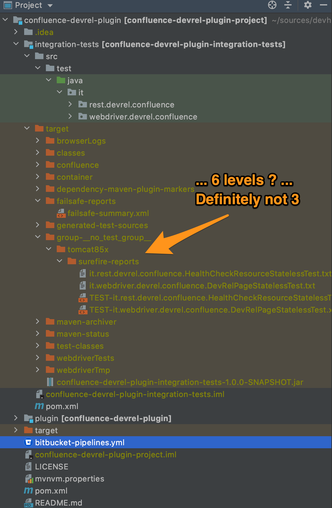

Looking at our default project structure and configuration, we can clearly see that the integration tests reports are generated as follows.
This means that we have to go back to our project definition, and make some more adjustments to our lovely XML.
We have to override where maven-failsafe-plugin stores its reports, we can just place them in the project’s root target directory:
<plugin>
<groupId>org.apache.maven.plugins</groupId>
<artifactId>maven-failsafe-plugin</artifactId>
<version>3.0.0-M5</version>
<configuration>
<reportsDirectory>${project.basedir}/../target/failsafe-reports/integration-tests</reportsDirectory>
</configuration>
</plugin>

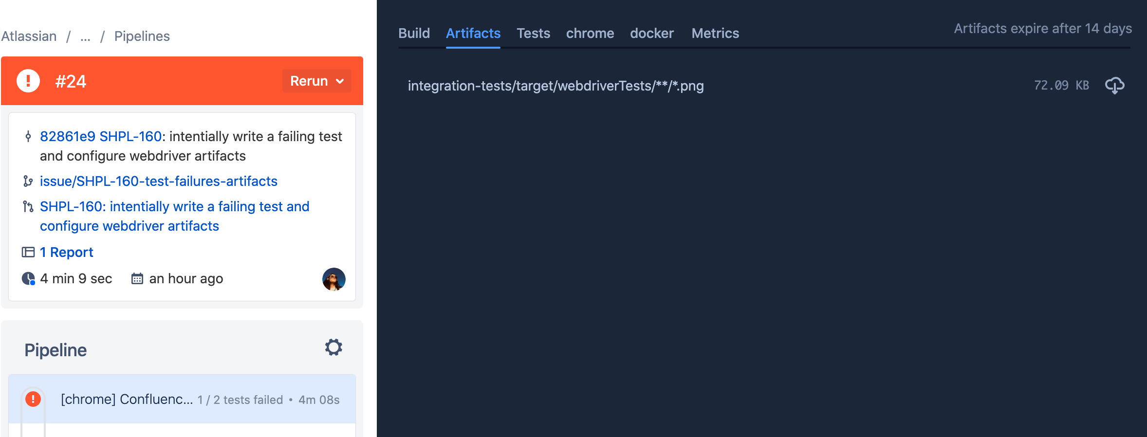

In case of test failures, our Stateless Test Runner is configured to capture screenshots which can help you understand and troubleshoot your tests. This is great, because we can update our pipelines configuration to extract them as artifacts !
- step:
name: "[chrome] Confluence 7.4.6"
caches:
- maven
services:
- chrome
artifacts:
- "integration-tests/target/webdriverTests/**/*.png"
