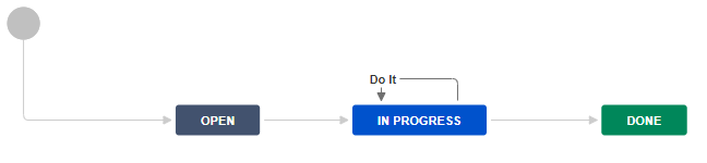

This is very different from a transition that returns to the same status. In the image below, you see a very simple workflow: Open → In Progress → Done. I have added a transition from In Progress back to itself called “Do It”.
This is a very standard way to allow execution of a set of post-functions without changing the status. You have probably implemented this dozens of times in your own environment. The problem with this solution is that it only works from the “In Progress” status. You can’t run it from Open or Done.
You could implement the same transition on Open and Done as well, but then you have three transitions that you have to maintain instead of one. If you have a more complex workflow with 8 or 10 steps, this approach quickly turns into a nightmare.

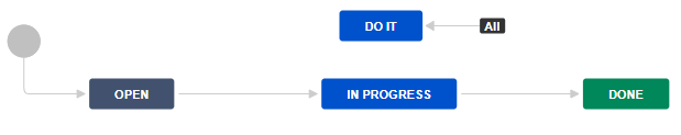

Create your base workflow
For our purposes, we are going to use the workflow that we created above. Instead of having the “Do It” transition go from “In Progress” to itself, we are going to create a new Status called “Do It” indicating that all statuses can transition to this one.
Notice that if you left this workflow as is, you could never exit the “Do It” status. Our next steps will solve that.

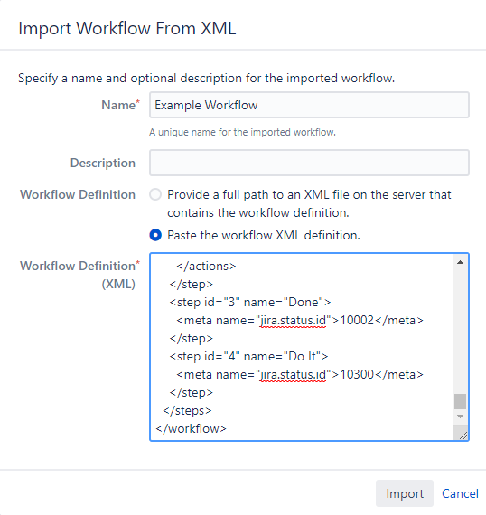

Import the XML as a new workflow
Now you are ready to import the workflow. Go to the Workflows page and “Import As XML”
You will need to give your workflow a new name since the name you used is already taken.
Select the “Paste the workflow XML definition” option and paste in the XML from your editor, as shown above.

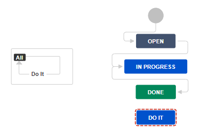

The new workflow will show up under the Inactive list, since it is not yet used in a Workflow scheme. When you look at the workflow in Diagram mode, it will look like this:
The “Do It” status and transition have been disconnected from each other. This transition will be available regardless of the current status of the issue. You can delete the “Do It” status from the workflow. We can never reach it anyway.
This new “Do It” transition has all of the properties and capabilities of a regular transition. You can set Conditions and Validators on it. You can add whatever post-functions you want. It will work just like any other transition, except that it is always available and never changes the current status of the issue.
