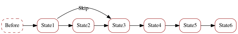

Directed graph: Jira workflow
This was an early effort to visually depict the change in status of Jira issues as work progressed. I used Bob Swift’s Digraph macro to create it. Each node contained a link to a corresponding wiki page with more details. The left-to-right orientation fits well with the page layout.
rankdir=LR;
rank=same;
node [shape=box,fillcolor=white,style="rounded,filled,dashed",color=brown,fontcolor=black]; Before;
node [shape=box,style="rounded,filled,solid"]
Before -> State1 -> State2 -> State3;
State1 -> State3 [label="Skip"];
State3 -> State4 -> State5 -> State6;

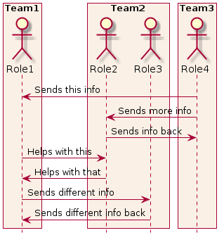

}Sequence diagram: Roles and relationships
PowerPoint can be useful as a thinking tool but sometimes results in messy slides with many arrows as people think things through. This sequence diagram shows the same information exchanges as the slide but is much tidier.
One advantage of diagrams is that they can be edited in-page instead of having to edit a PowerPoint presentation, export slides as static images and then insert them into a wiki page.
@startuml
hide footbox
box "Team1" #linen
actor Role1
end box
box "Team2" #linen
actor Role2
actor Role3
end box
box "Team3" #linen
actor Role4
end box
Role4 -> Role1 : Sends this info
Role4 -> Role2 : Sends more info
Role2 -> Role4 : Sends info back
Role1 -> Role2 : Helps with this
Role2 -> Role1 : Helps with that
Role1 -> Role3 : Sends different info
Role3 -> Role1 : Sends different info back
@enduml

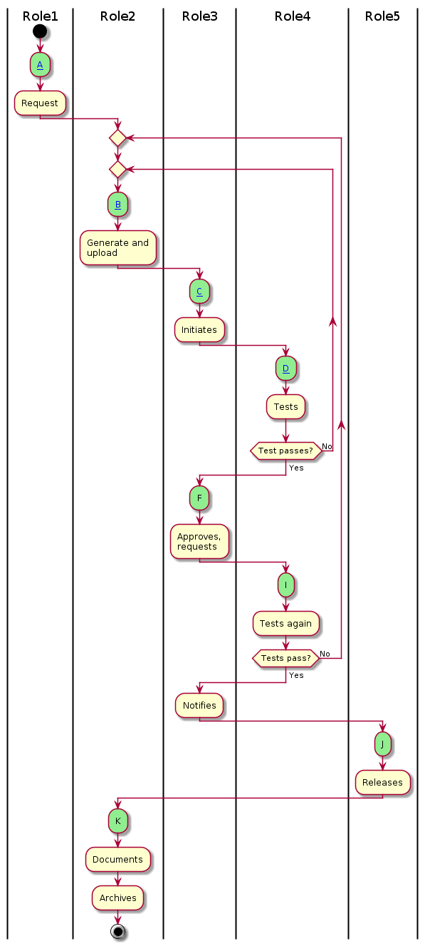

Activity diagram: Qualification process
As I got better at diagramming I could tackle more complex processes. This one was an important and complicated process involving no fewer than five roles and several rounds of testing. If tests failed at any point in the process, it was “back to square one.” To insiders, this process was second nature and based on personal relationships. To outsiders it was understandably confusing. Now they are better equipped to contact people depending on where things are at.
In the actual diagram, the green ovals are linked to anchors on the Confluence page with more details about each step, but here they are linked to Google so you can see the syntax. Some of the steps are notifications, not actions, which helps ensure that the appropriate people are notified at certain points.
@startuml
|Role1|
start
#lightgreen:[[http://www.google.com A]];
:Request;
|Role2|
repeat
repeat
#lightgreen:[[http://www.google.com B]];
:Generate and
upload;
|Role3|
#lightgreen:[[http://www.google.com C]];
:Initiates;
|Role4|
#lightgreen:[[http://www.google.com D]];
:Tests;
repeat while (Test passes?) is (No)
-> Yes;
|Role3|
#lightgreen:F;
:Approves,
requests;
|Role4|
#lightgreen:I;
:Tests again;
repeat while (Tests pass?) is (No)
-> Yes;
|Role3|
:Notifies;
|Role5|
#lightgreen:J;
:Releases;
|Role2|
#lightgreen:K;
:Documents;
:Archives;
stop
@enduml
