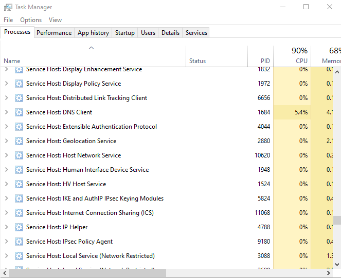

Next, you need to find the process that is running Jira. Open the Windows Task Manager and add the Process ID column to the view
Look through the process list until you find your Jira process. Depending on whether you are running it as a service or from the command line, it will appear differently in your list. Regardless of how you find it, you will need the process id.
