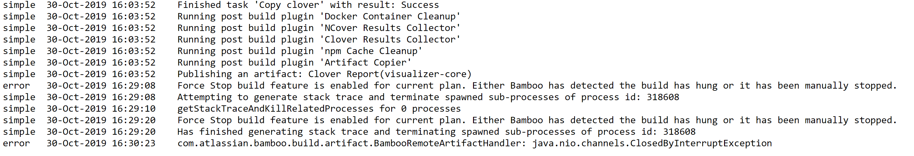

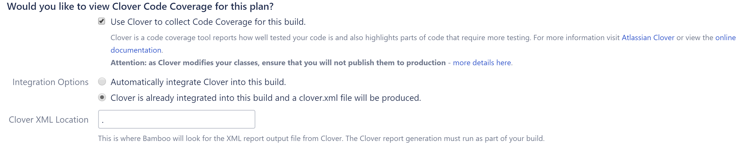

I have some jobs that post some clover reports. I do this by using a script to copy the clover reports generated for the build into the current job and having bamboo detect these clover files in the "Job Miscellaneous" configuration. The logs show that everything ran successfully but the job hangs and doesn't complete. Once the job times out the job is successful and continues to the next job. Why is the job hanging? Is there a bug in bamboo's clover feature I'm not aware of? It was previously working.
Here is my configuration
The output I get is shown below, everything looks fine.
