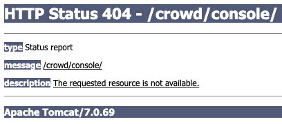

I'm attempting to create an instance of Crowd, mirroring its Live counterpart for our Testing environment. I've cloned the container and changed some few key configuration, as described below. The problem is that while the URL loads this test version of Crowd, clicking "Set up Crowd" gives the following error:
The overall landing page looks oddly plain too, without nice-looking buttons and formatting, if that's any hint.

Output of catalina.out: https://pastebin.com/GGiCrhPT
atlassian-crowd.log doesn't have a single line after the server was last stopped.
I have also verified that crowd/console exists with correct permissions in /opt/atlassian-crowd-2.11.1/crowd-webapp/WEB-INF/classes/com/atlassian/crowd just as it does in Live.
