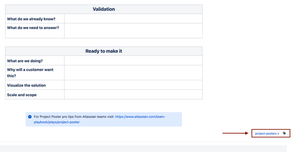

When you create a project poster from the project poster template, you will see that at the bottom of the page a label is assigned. In the example below, this label is "project-posters":

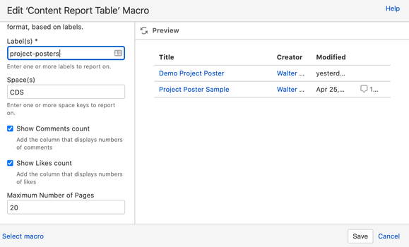

The Content report table macro generates the list of all project posters. It is really easy to configure, as it only requires you to specify these parameters:
