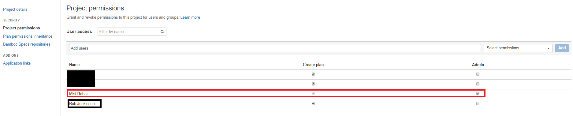

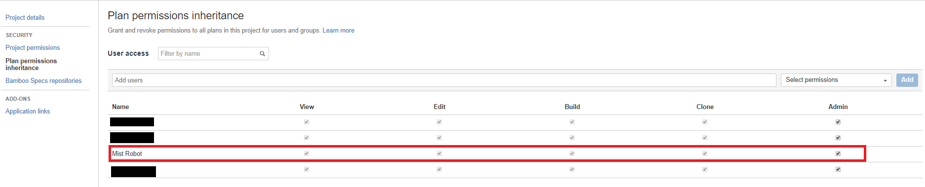

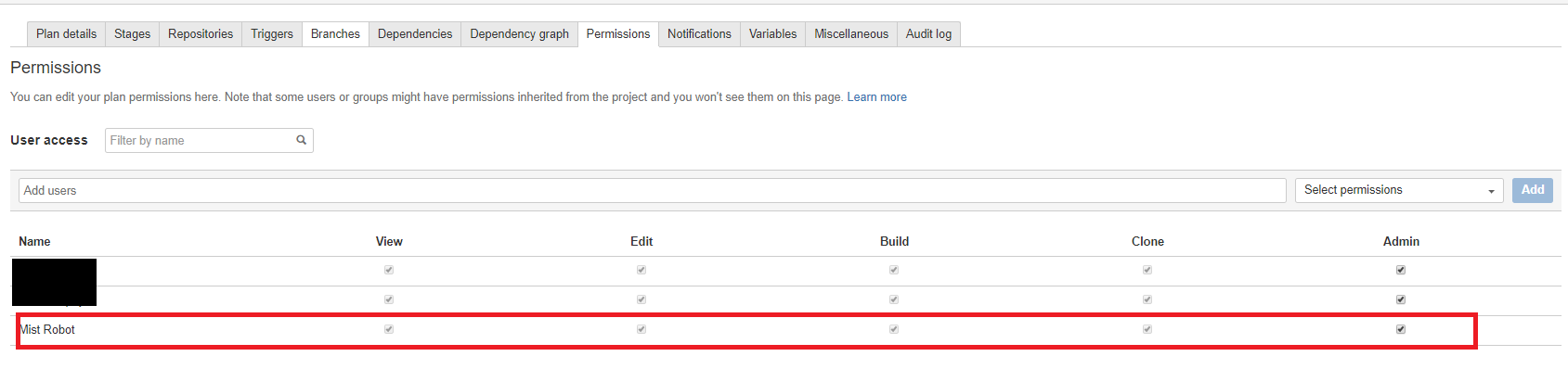

What could be going wrong, what else should I check? I have the following permissions set on the project and plan:
