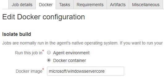

I am trying to run build plan on a windows docker container instead of directly on windows agent itself.
For some reason bamboo tries to start docker container with "--net host" mode and since windows container doesn't support this mode, it is failing. I need to find a way to prevent bamboo from using host mode, but I am not finding any configuration in my bamboo server.
Bamboo is trying to start container like following:
