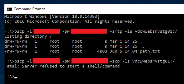

I have installed SolarWinds SCP server on that box, and I can have verified that I can use the following putty command to list the directory contents on the target from the bamboo server
pscp -l [user] -pw [password]-sftp -ls vdcwwebsrvstg01:/
Note that if I force pscp to use scp, I get the following error:

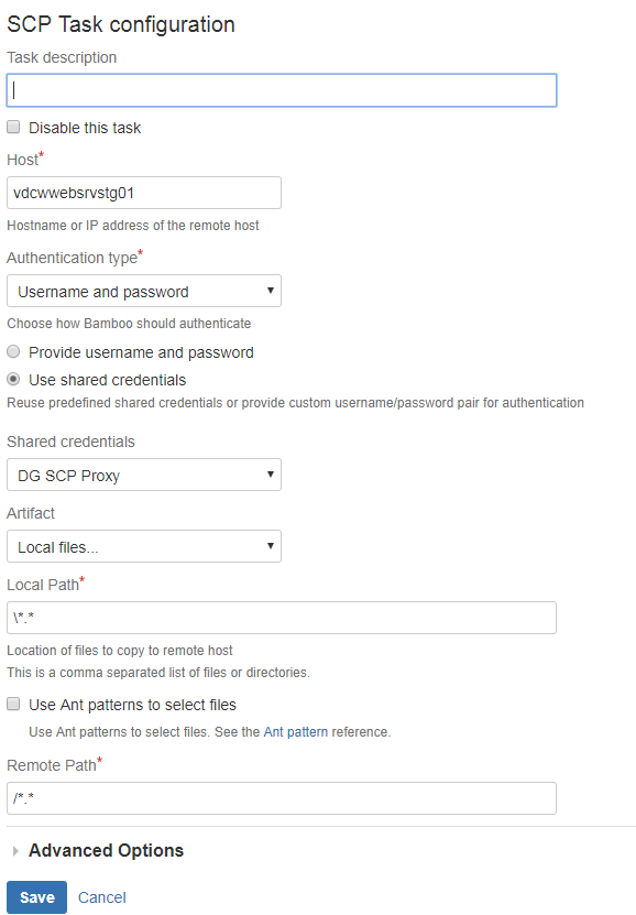

The Bamboo SCP task however consistently fails with the following error when trying to upload README.txt
"scp: Failed to open file '/*.*'"
This happens regardless of how I set the remote path (which I believe should be set to "/*.*"
I've attached the config for the Bamboo SCP task
