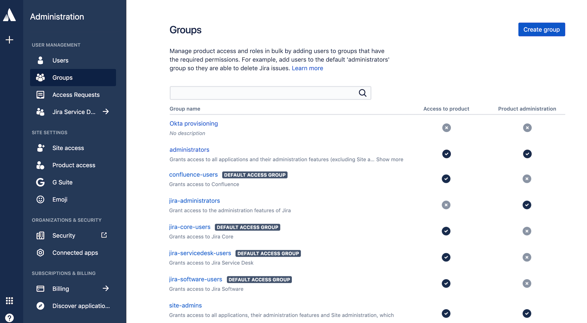

1. Select your local group/s under Group menu at the admin's page (https://<example>.atlassian.net/admin):
2. Use the Delete group option:
3. Proceed with Delete group:

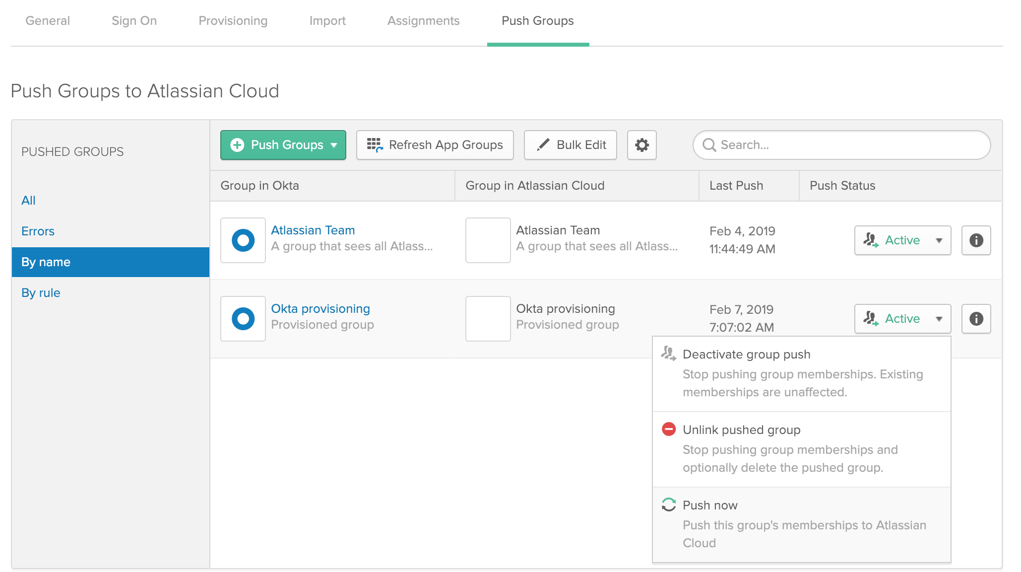

4. In Push Groups section under your Okta app, use the Push now option to re-create the group/s:
Concluding those steps the groups will be re-added to the application and you'll have to apply the permissions scheme and project roles that are desired to the groups.
