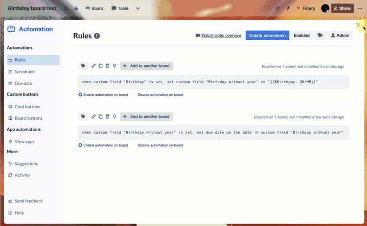

Here's an example of how I used date formatting to create the rules:
  • I created the Custom Fields Birthday and Birthday without year.
  • This rule was created to populate the Birthday without year field
    when custom field "Birthday" is set, set custom field "Birthday without year" to "{{%Birthday~ DD/MM}}"
  • This rule will populate the due date with the date set on Birthday without year
    when custom field "Birthday without year" is set, set due date on the date in custom field "Birthday without year"
  • Now I'll have the due date with the birthday on the current year (or the following year, depending on the month)

Thanks for sending your question. I just tested it to confirm, and it works. Both Custom Fields were created as date fields.
I recorded a quick GIF video to show the rules in action.
Do you have any error messages while trying to create the rules? If so, could you please send them here?

You can copy and paste the Custom Field name. As the option is originally made to use with fields other than date, the date Custom Fields are not listed. However, if you fill in the Custom Field name manually, it should work.
