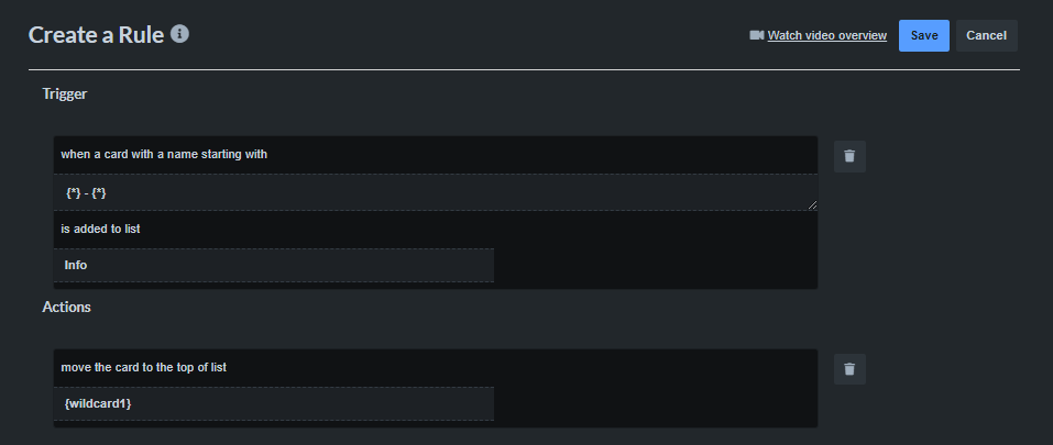

I have a similar question and hope it's ok I just jump in on this thread... I would like to move the card to a list on another board where the list name is the beginning of the card name... i.e. When card "Client - Jobname" is moved to the list "Done" move to List  " starts with {triggercardname} {variable for client" on Board "Client Archive"
I am trying to figure out how to structure the variable for moving to a list where the list name starts with Client name which is the first part of the trigger card to save me from having to create an automation for each client...

Hi @Oliver Rathonyi-Reusz
When a card with a name starting with {*} - {*} is moved to the list "Done", move the card to list "{wildcard1}" on board Client Archive

Thanks @Mike - Dreamsuite Consulting , I think I know where you are going, however, when I do it, It creates a new List on Client Archive with the title of the card...

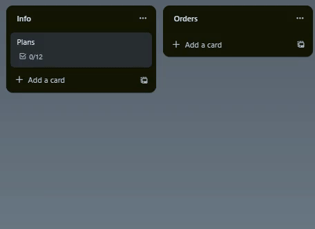

July 3, 2023
I just tested it and it works for me (on the same board but the theory is the same)
July 3, 2023
Thank you so much for the screen shot - that helped me understand that I was missing a crucial step - I was typing in the {*} - {*} variable but NOT opening the contextual menu and hitting the "+" sign, so I was not actually adding it! I would see it when I went to edit the trigger, but not when I did the final add.  Now it works perfectly! Thanks again.
