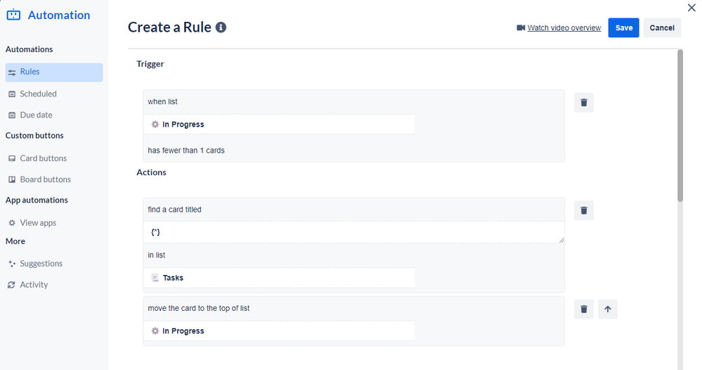

Hi all- looking to use automation to drive my workflow a little bit better.
I have three lists:
  • Backlog
  • In Process
  • Done
I only want to have three items in the list at one time, so I've been using the trigger "when list has fewer than 3 items" as a starting point. Once I move an item from In Process to Done, I'd like the automation to move the top card from the Backlog list into the In Process list. But I can't seem to find the Action that would do that.
Is this something that is possible with Automations? Thanks!
Mike - Dreamsuite Consulting
August 15, 2023
You can indeed to this...
Steve West
August 15, 2023
Thanks Mike, this worked perfectly! Really appreciate the help.
August 15, 2023
No problem.  Using Trello as a pull system seems absolutely perfect to me....
