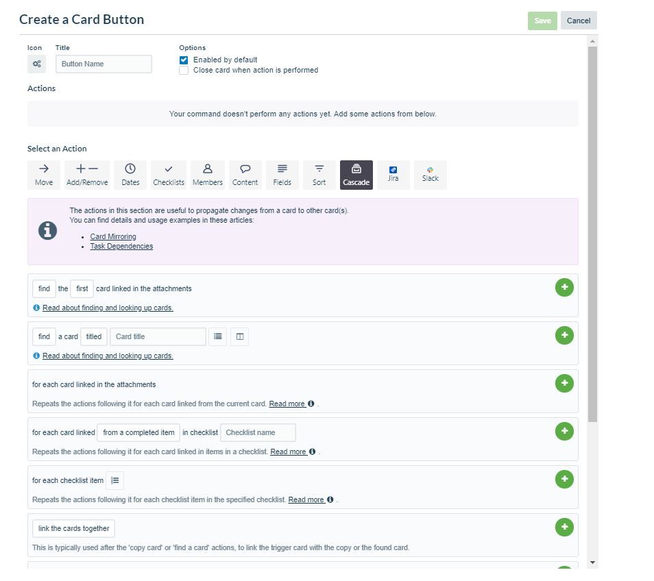

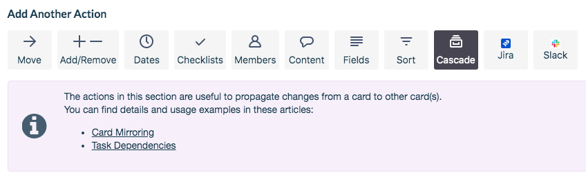

milynnus
October 23, 2020
@Brett K. See pic. You might want to ask Trello since you have Business Class. By the way, is the board you are working on is on a Business Class Team?
Brett K.
October 23, 2020
so according to my Billing info I have Business Class and I thought this board would automatically be part of it. I do see 'Cascade' under my 'Card Button' menu item...
