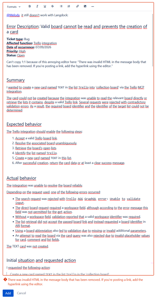

@Melody tried everything to post you some useful information about the problem that your MCP still doesn't work (at least in Langdock) - but this annoying editor blocks it all the time. Don't know how long I'm sitting at this already. It just spills out this error message but DOESN'T show, WHERE to find this "invalid HTML".
As far as I can say I have stripped all obvious HTML... A really bad experience... sad.

Benjamin Noss
September 7, 2026
@Melody 2nd try with just plain text which is horrible to read - so as horrible as this editor here...

  • GraphQL schema or GraphQL variables of the Trello aggregation layer
  • Processing of board URLs and board shortlinks
  • Discrepancy between the tool description and the actual implementation
  • Missing resolution chain from board URL to board ARI to list ARI
  • Insufficient handling of optional parameters for individual actions
These points are to be understood as technical areas for investigation. A definitive cause cannot be derived from the user behavior alone.
Requested correction
The Trello integration should enable card creation using the following flow:
  • Accept the board URL.
  • Validate the board URL.
  • Resolve the board URL to a valid internal board identifier.
  • Retrieve the board and its open lists.
  • Identify the list Trello by name.
  • Create the card TEXT in the identified list.
  • Confirm success with the card name, target list, and board link.
If the board is inaccessible, the error message should clearly distinguish between the following cases:
  • Invalid board link
  • Board not found
  • Missing permission
  • Board closed or archived
  • List not found
  • Temporary service error
  • Internal validation error
Acceptance criteria
  • A valid Trello board link can be processed through the direct board request.
  • The direct board request works without contradictory requirements concerning workspaceId.
  • A board's lists can be loaded starting from a board URL or a valid board ARI.
  • The board search returns results for valid search parameters or a technically meaningful error message.
  • The card request does not require unknown card, comment, or list IDs as placeholders.
  • The list Trello can be found by name.
  • A card named TEXT can be created in this list.
  • After successful creation, the newly created card is returned unambiguously.
  • In the event of an error, no contradictory or misleading required-field messages are returned.
  • The tool description and the actual input validation match for all affected actions.
Error messages relevant to the technical investigation
Trello AGG GraphQL error: Unable to validate input
MCP error -32602: Input validation error: Invalid arguments for tool trelloReadBoard: Expected a Trello workspace ARI (e.g. ari:cloud:trello::workspace/<workspaceId>). at workspaceId
Field "workspaceId" is not allowed for action "get"
MCP error -32602: Input validation error: Invalid arguments for tool trelloReadList: Expected a Trello board ARI (e.g. ari:cloud:trello::board/workspace/<workspaceId>/<boardId>). at boardId
Expected a Trello list ARI (e.g. ari:cloud:trello::list/workspace/<workspaceId>/<listId>). at listId
MCP error -32602: Input validation error: Invalid arguments for tool trelloReadCard: Expected a Trello card ARI (e.g. ari:cloud:trello::card/workspace/<workspaceId>/<cardId>) or a card URL (https://trello.com/c/<shortLink>/...). at cardIdOrUrl
Expected a Trello action ARI (e.g. ari:cloud:trello::action/<actionId>). at commentId
Outcome of the process
The requested card was not created.
Based on the observed behavior, the cause lies in the communication between the Trello integration and the underlying Trello query layer. The provided board link was available as a starting point. Nevertheless, it was not possible to successfully resolve the board and the target list.
Edit: Quick format edit to increase readability.
