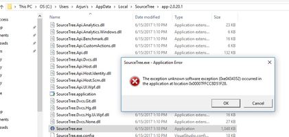

Can you see if you can run
%localappdata%\SourceTree\app-{VERSION}\SourceTree.exe ?

I did found the SourceTree.exe under the path that you specified, but when i tried to run it i got a exception. i have attached the scrrenshot for the exception.
