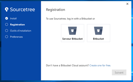

Registration step failed with Authentication Success. The "Next" (Suivant) button is always disabled. Does someone has already solved this issue ?

I want to install Sourcetree 3.1.2 with my Bitbucket account. But when I grant the access on firefox, nothing append in sourcetree. The "suivant" button is still disabled.

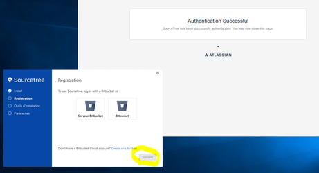

Latest version of SourceTree. Bitbucket option. Using Internet Explorer - within a corporate network. They got the "Authentication Successful" page, but Sourcetree never updated to allow the Next button to be clicked.

I've now reached the same stage (there were local permissions issues in IE trusted sites - the atlassian site wasn't allowed to redirect) - I have this page -
Authentication SuccessfulS
S
But still no registration on SourceTree.

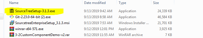

1) I realized I had downloaded the Sourcetree Enterprise version and it's an .msi file. So make sure you are getting the .exe file instead from here https://sourcetreeapp.com/?v=win

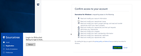

3) when you are prompted to the installation window (with the "Install", "Registration, etc list on the left), click on "Bitbucket", which will prompt the URL page to authenticate. DO NOT "grant access" yet. Copy the URL link
4) paste it in another browser (I used Explorer), grant access, there... Things may work then!
