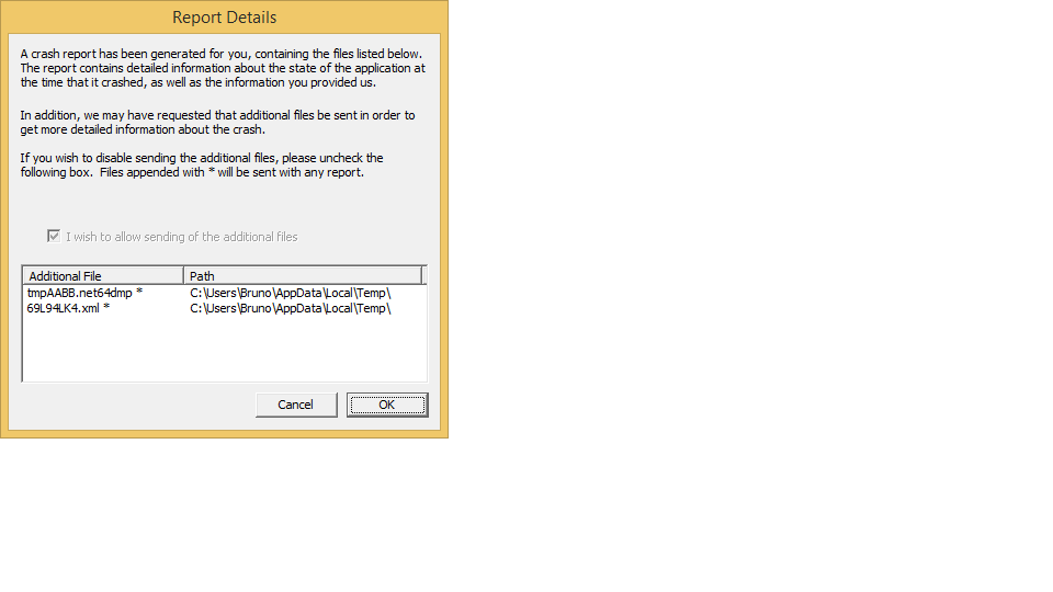

February 5, 2020
error.pngit's not work and this is my error
