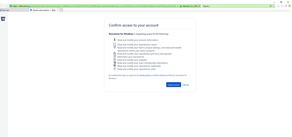

2. Clicked Bitbucket for login.
3. Got this screen to Grant Access.

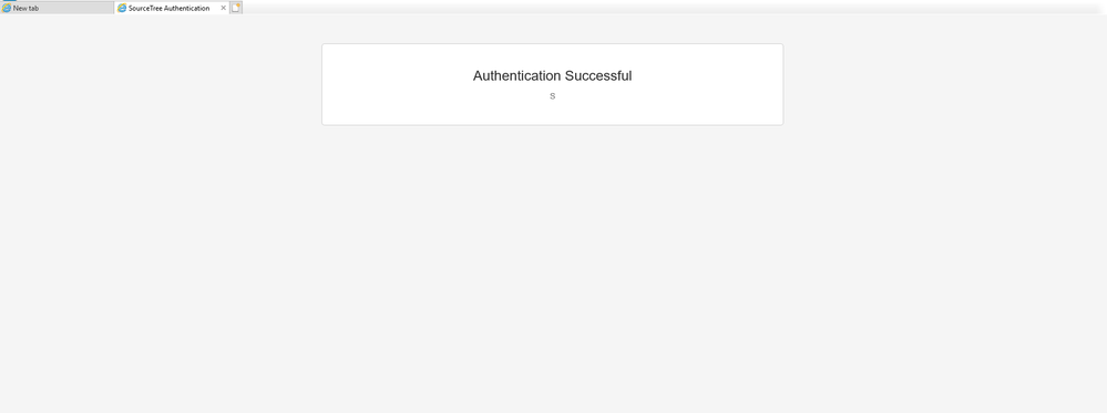

SourcetreeIssue.png4. After Granting access i get the Authentication Successful prompt as below.

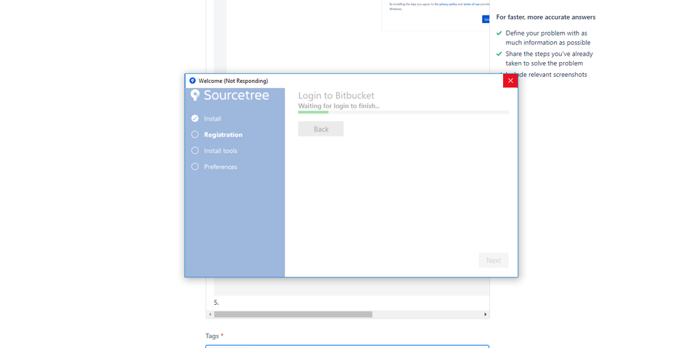

SourcetreeIssue1.png5. Source Tree prompt becomes non-responsive as shown below.

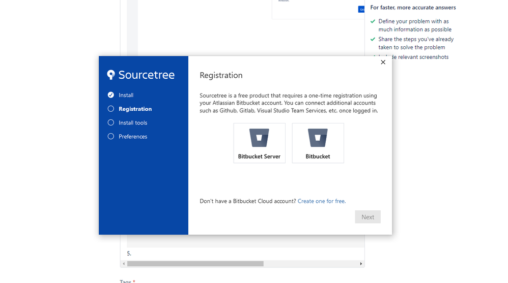

SourcetreeIssue2.png6. Finally Ends up again on Square one as below.
