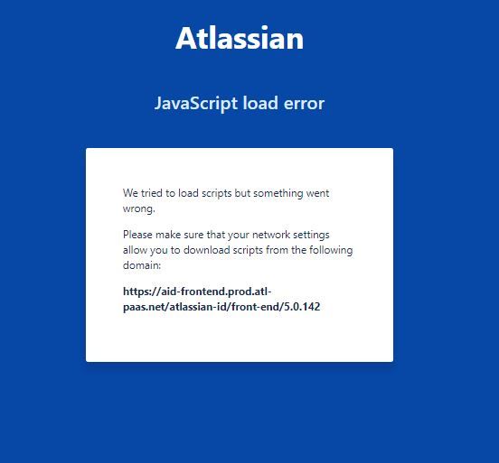

Unable to install the software as I get this error when prompted to log in:
Log in with Atlassian account
AtlassianJavaScript load errorWe tried to load scripts but something went wrong.Please make sure that your network settings allow you to download scripts from the following domain:https://common-admin-cdn.atlassian.com/atlassian-id/front-end/2.1.3
Following the above link leads me to a webpage with
<Error><Code>AccessDenied</Code><Message>Access Denied</Message><RequestId>9ACDDDD102127D48</RequestId><HostId>DHYA0YJApXFs7jYVt33q55p9cyCMDACZzmZvM3z/5O+0JbnhZ8lnO3ubmzzj5RyqGG5MgrzodK8=</HostId></Error>
Nothing unusual about my home network setup. I'm on Windows 7 64.

Hi Jon,
This is usually caused when id.atlassian.com is able to load but the scripts that make up the remainder of the page/app aren't, typically due to restrictive network settings. The can resolved by whitelisting per this article: https://confluence.atlassian.com/cloud/atlassian-cloud-ip-ranges-and-domains-744721662.html

Please check is any ad blockers are running. If any please disable.
Yup, had this problem too. Disabling the adblock helped.

Hello, you do one thing install IE(internet expl version 8-11). your prblm will find solution automatically.
I had the same problem after clearing the cache of my Google Chrome. Then whenever I tried to Login the JIRA using my office network I was facing the issue. Then I connected my Laptop with my phone's internet using Hotspot. After that JIRA is working fine for me even in my office network

Issue got fixed by connecting to another network.
Good day all,
Please assist. Im using the new update MS Edge and im getting the error below, can it be fixed as well or Atlasian site strictly supports chrome?
