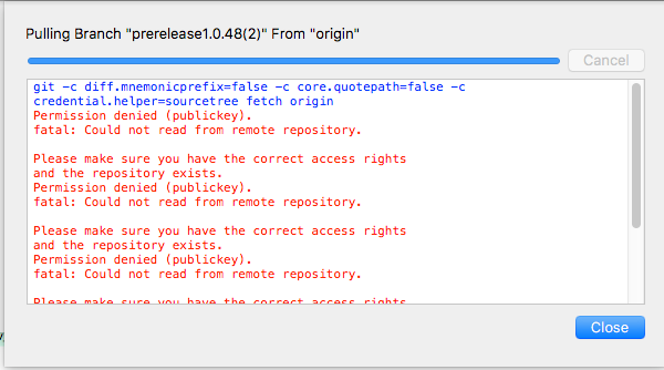

Iam Using source tree from last 1 year.But from last 2 months iam facing an issue.ie premission issue.While in pulling and in pushing it show like in (Attached Image).Daily iam generating new ssh key and continue my work.But it shouldn't .Please provide permenant solution for these problem.sourcetree3.png

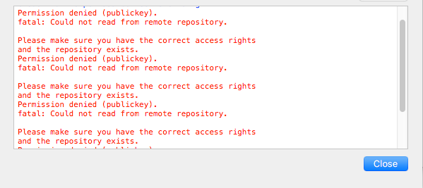

Mahesh Nallabothula
June 20, 2017
Hi Ana Retamal Ortiz,
Thanks for your immediate response.right now Iam using 2.5.2(111) & OS is 10.12.5. It's happening with specific repository only.When I start using any command on next day,it shows (i.e see below attached image).Screen Shot 2017-06-21 at 11.36.20 AM.png
Mahesh Nallabothula
June 20, 2017
Please provide any suggestion for these problem.
