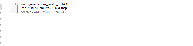

I thought I had a virus. Source Tree keeps generating gravatar files in the recycle bin

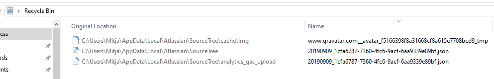

Here's a screenshot of the Recycle bin. As you can see the file was deleted from the SourceTrees cache folder, this is why I suspect Sourcetree is responsible for deleting them. Maybe you should just do a delete without adding the file to the recycle bin?

mbezensek
September 9, 2019
I just checked the recycle bin again and there are some additional files, not only avatars. It seems like some json files are also being deletedsourcetree2.pnged.

The json files are user analytics data. Sourcetree records clicks etc then packages them into temporary json files before bulk submitting. After that it deletes the temp file.
Sourcetree pulls gravatar icons to display against accounts.
I'm guessing here but I suspect it just periodically deletes the existing one and gets it again to ensure it has the latest version. Alternatively it might be just part of the download process before the final file is written to its final location.
Finally there was a recent change in Sourcetree to support delete to recycle bin. I may well be that previously these files were explicitly deleted but now the delete to recycle bin option is on they go to the bin.

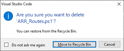

I have no problem with Sourcetree putting the deleted files in the Recycle Bin  when the action was initiated by the user.  In other words: if I went into my repo and deleted a bunch of files then those files can go to the bin.
This, above, is the type of behaviour of programs like VS Code.  I see things in the recycle bin that I know why they are there.  I can recover my own stupid actions.
However, programs like VS Code are also doing a bunch of internal actions, all day long.  VS Code will add, remove, modify several files.  Some are in Temp locations on my computer and others are in dedicated hidden folders like the ".vs" folder.  However, none of those internal actions every end up in the recycle bin.
