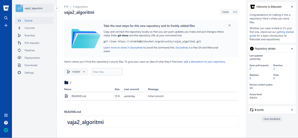

1. I created a new repository on Bitbucket. The "master" branch also got created in the process and it included the README.md file.

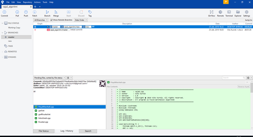

2. I then made a new repository on my computer using Sourcetree. I committed a few files and they were all in the "master" branch.

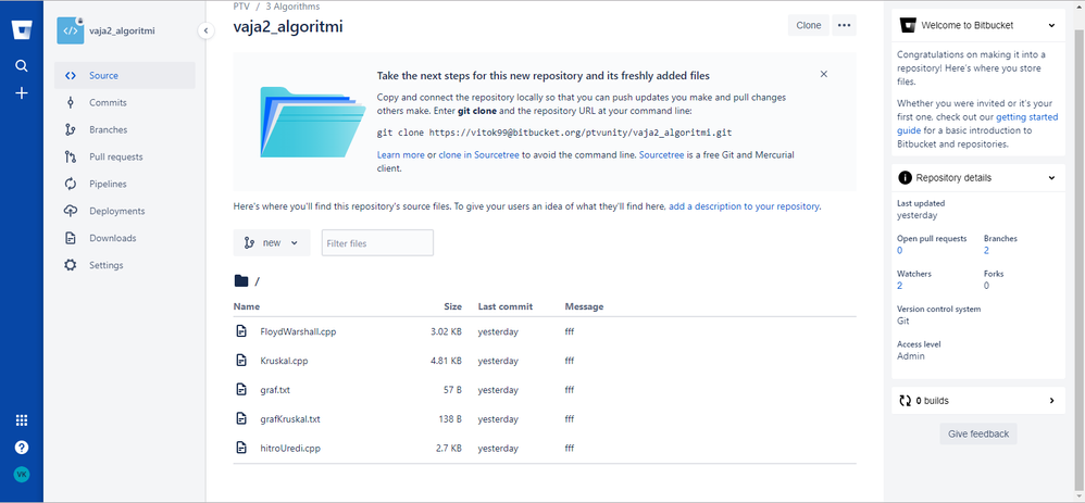

6. After multiple attempts, I couldn't push the files from Sourcetree to the Bitbucket repository into the "master" branch. But then I made a "new" branch and it worked but I wanted the files from Sourcetree to be in the "master" branch in Bitbucket. I tried to merge the two branches on Bitbucket but I couldn't because they're unrelated.

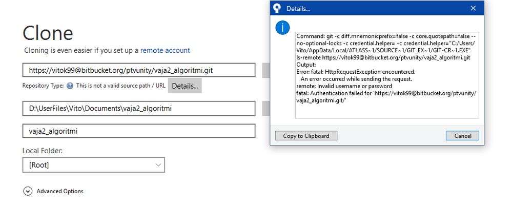

Apart from the error message screenshot, I'm also adding the screenshots from Sourcetree and Bitbucket.
Okay, so the first error message indicate that your username or password is incorrect, so you should make sure that the password stored in Sourcetree and Windows Credential manager is correct.

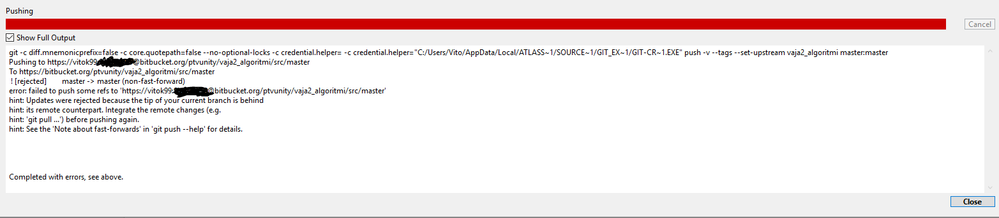

I made sure of that but even after that, I wasn't able to push the files which I committed to the "master" branch in Sourcetree to the "master" branch in Bitbucket. I didn't capture that error message though - I hope you might still be able to help me anyway considering my description of what went down.
There are lots of things that can prevent you from pushing to a specific branch, for example branch permissions, hooks, etc. Do another push of master and see what error message you get.
That's what I get. Even after I performed the action "pull" (a few days ago when this problem occurred and I had to "make a compromise" to finish my school work) I still couldn't get the files to be pushed into the "master" branch on Bitbucket. It was sort of untouchable, so to speak. And the only way to not get the invalid username/password error for me is to include username:password in the link to the repository on Bitbucket which isn't very private since I have to take screenshots for my school work. I was trying to sort things out in Sourcetree in Authentication bar in Tools>Options, but these credentials, or whatever you want to call them, confuse me, the whole process does.

Believe it or not, I've tried that before as well. But, a familiar error message appeared:
So try this, go to c:\users\<your user ID>AppData\local\atlassian\sourcetree and remove the passwd file. Then go to Credential Manager (under control panel) and remove any references to Bitbucket. If you now do another clone you should be asked to enter your Bitbucket password.
