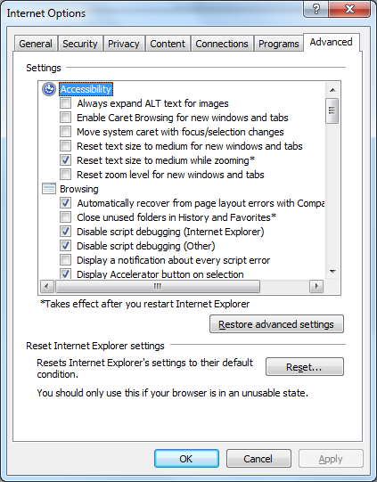

Workaround
At a minimum IE needs to be configured as follows:
Cog/Internet options/Security settings need to be enabled
These can be set using the F12 developer tools.
Those are the settings that matter. It should also be able to set them indirectly by:
Yes, that worked.
Several important notes:
1. Restart IE after changing Misc and Scripting behaviour
2. The login with Google won't work in that case. But atlassian ID finally worked.
And in my case setup failed (suspended after OAuth setup step). So I did not even saw other options in installer. But somehow the application works now :)

Konstantin, IE is inevitable ... unfortunately. If you read the provided issue link - there's a detailed explanation why is it so.
Regarding your last question:
Misc stands for Miscellaneous. But this is wrong menu, you should try `Security` tab and `Custom level` button.

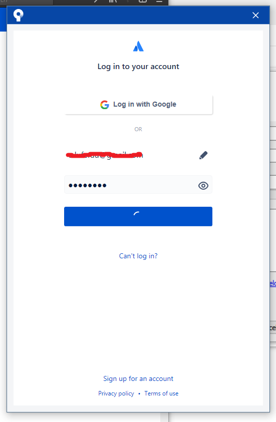

I have maybe the same issue: 3 day I can't install Sourcetree. Only see the spinner on the login popup.
Yes, this is exactly what I had. Consider trying the same solution.

I have the same issue as Aliaksandr. I can't install because installation hangs on login. The spinner does not stop spinning.
I'm using Windows7 and IE 11.
Installation only succeeds when I'm logged in as administrator. But then I cannot use the installation as a "normal" user.
Any suggestions?

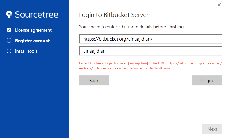

my logon isssue has noting to do w/ the browser.. i'm just using the SourceTreeSetup-2.5.5.exe windows program.
the installer asks for root url and username at the register account step
and i have no idea what they are supposed to be
i tried
https://[username]@bitbucket.org/[username]/[repositoryName]/
https://bitbucket.org/[username]/[repositoryName]/

I think you are trying to use the option to register against a Bitbucket Server installation, if you don't use Bitbucket Server you need to use the Atlassian account option.
yes, i think thats correct.

Hi, i've some error..
I can't log in with BitBucket Serve, it always "Failed to check login for user"
And i try to log in with use an existing account Atlassian Account, when i click the button always show error

The Bitbucket Server option authentications against a locally hosted instance of Bitbucket Server, not the cloud version of Bitbucket hosted at bitbucket.org

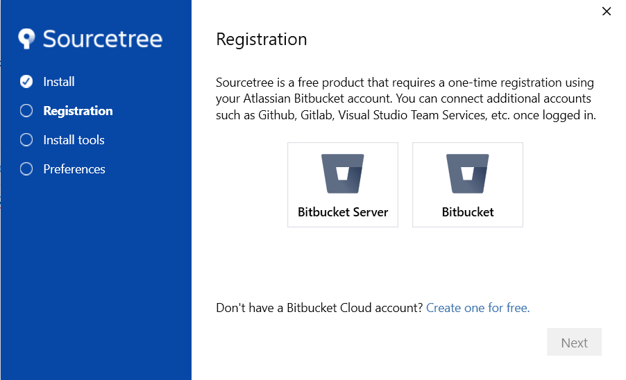

We are currently in beta testing of v3.0 which includes an option to register via Bitbucket (cloud) without needing IE to interact.
You can find details of the beta program here https://blog.sourcetreeapp.com/2016/03/25/sourcetree-beta-program-is-here-become-a-trusted-tester/
We hope to release this version soon.

We are in the process of rolling out v3.0 of Sourcetree. This replaces registration via Atlassian account, tied to Internet Explorer, with registration via Bitbucket.org which makes use of your default OS browser.
You can download an installer from: http://product-downloads.atlassian.com/software/sourcetree/windows/ga/SourceTreeSetup-3.0.6.exe

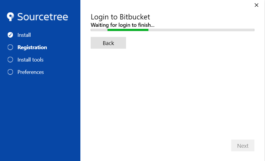

Can you describe what does/doesn't happen as you go through the login flow?
Thanks
- I run SourceTreeSetup-3.3.8.exe installer
- On registration step
I click Bitbucket option
- then it redirects me to browser window and run link
- and I see that. And it doesn't do anything else
Ok funnily enough that should work.
I'll try and have a play later today.
Are you in a corporate environment, proxies, security or anything or just a standard windows environment?
Thanks, @minnsey
Yes I have standard windows environment, but we can't be sure that all settings are clean enough due to the fact that I use this env. as my main development environment and it is protected by antivirus.
I wish I can say more but I do not know if installer write some logs where I can find what it is waiting for.... Maybe some port is blocked or smth like that. and. Since I see Auth0 authentication I would expect that installer is waiting some inbound traffic.
