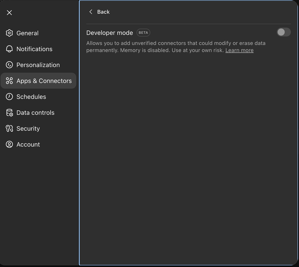

Ibby
October 6, 2025

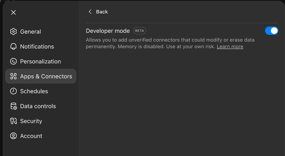

You need to enable developer mode first in normal chat.

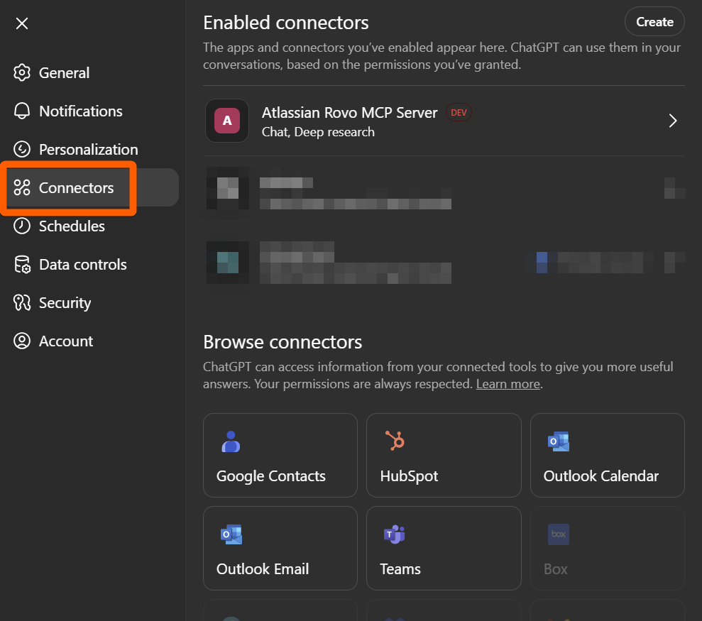

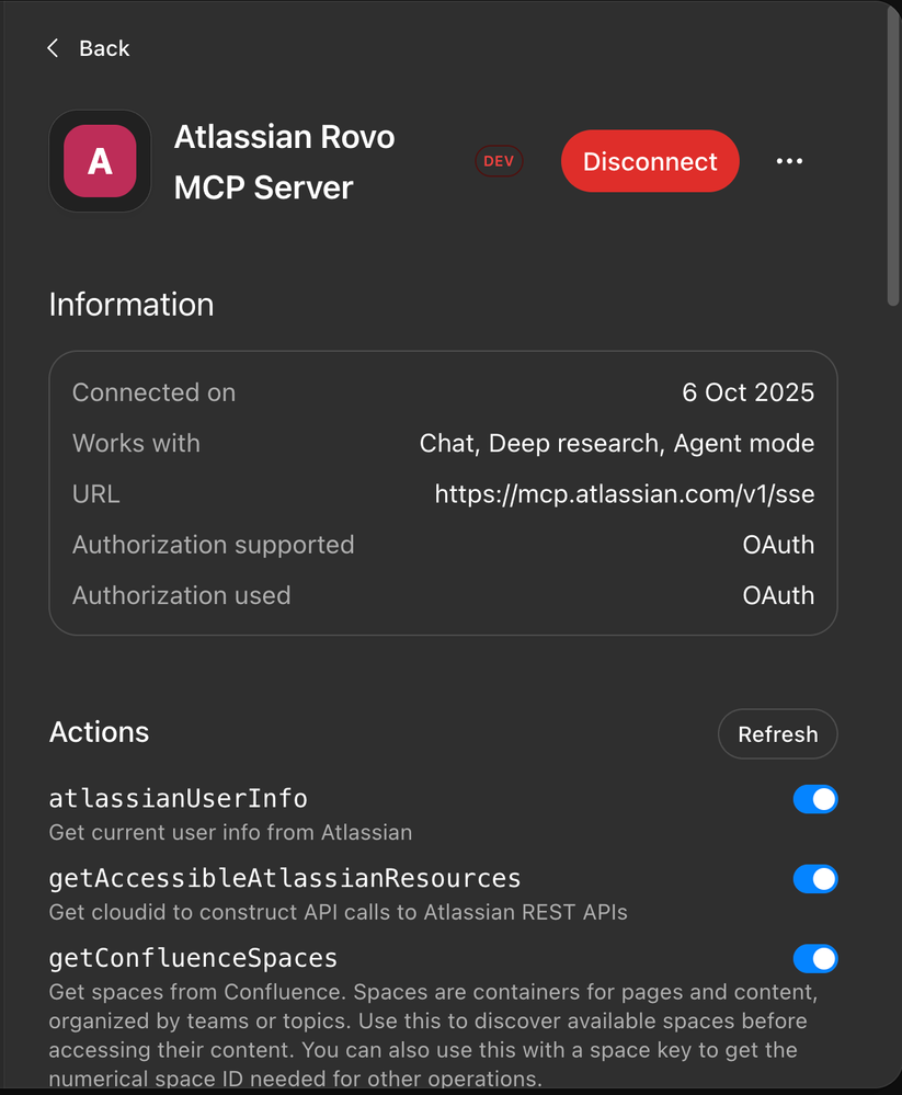

Screenshot 2025-10-06 at 7.30.49 pm.pngScreenshot 2025-10-06 at 7.30.24 pm.pngScreenshot 2025-10-06 at 7.30.05 pm.png

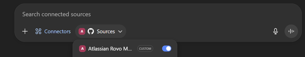

Ibby

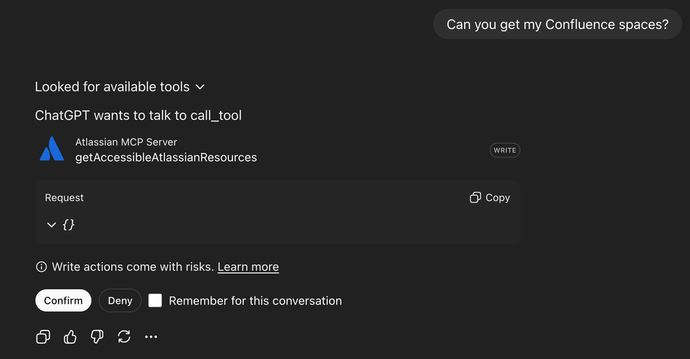

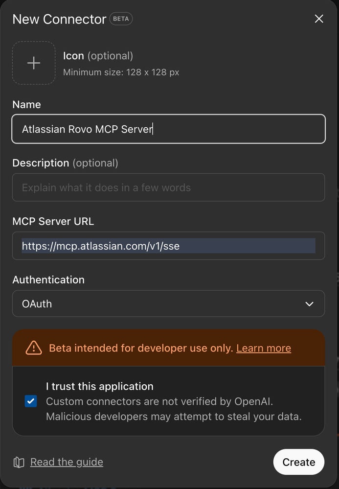

October 6, 2025
I just created a new one on the fly and as per the screenshot the connector supports Chat, Deep Research and Agent mode.
Screenshot 2025-10-06 at 7.33.38 pm.pngScreenshot 2025-10-06 at 7.32.40 pm.png

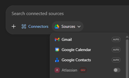

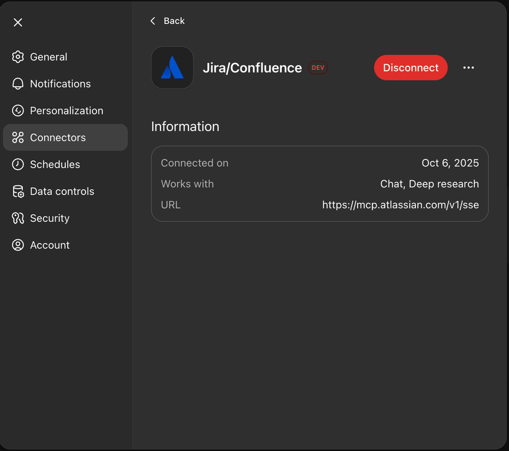

Blake Hedlin
October 6, 2025

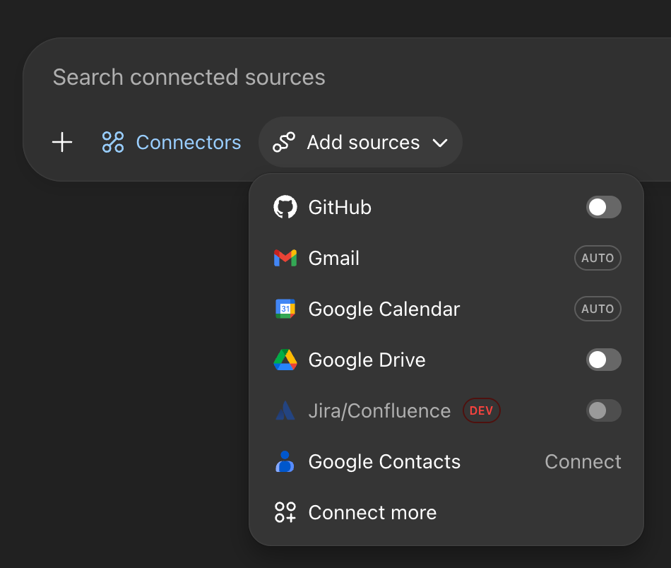

@Ibraheem Osama It worked a couple weeks ago but has since stopped. I am able to authenticate my Atlassian account but then it is grayed out when I try to use it. I also don't see Agent Mode or the additional Actions you see in your screenshot.
Screenshot 2025-10-06 at 11.56.46 AM.pngScreenshot 2025-10-06 at 11.56.10 AM.png
Like Alexander Corradini likes this
Alexander Corradini
October 7, 2025
FWIW we're having the same issue as Blake: the connection is configured and shows "Works with Chat, Deep research" but when trying to use it in a prompt, the option is grayed out.
Ibby
October 7, 2025
Thanks @Blake Hedlin  and @Alexander Corradini

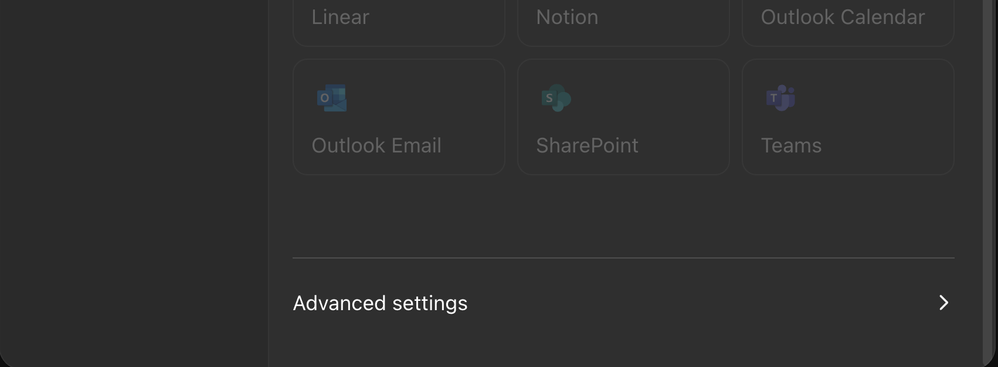

Could you please confirm if developer mode is enabled or disabled for you?
If you go to Apps & Connectors, then scroll at the bottom in the connectors page there is a section called Advanced settings once you click on it, then developer mode should be there where you would need to enable it.
Please let me know how it goes.

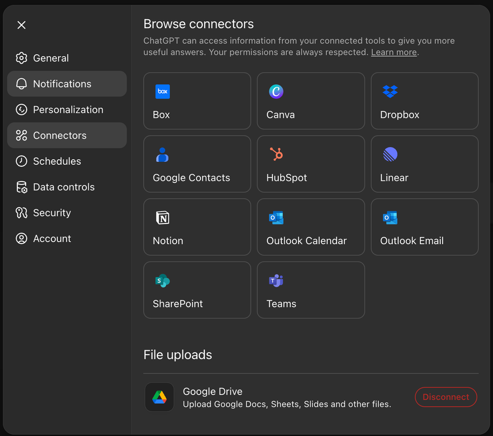

Blake Hedlin
October 7, 2025
The Advanced Settings option isn’t showing for me.
Do you know if this is restricted to Admin-level accounts? I’m listed as a “Member,” and it’s not clear from OpenAI’s docs (or ChatGPT) whether only Admins or Owners can configure it.Screenshot 2025-10-07 at 7.56.47 AM.png
Alexander Corradini
October 7, 2025
I also don't see a tab called `Apps & Connectors`, I only have `Connectors` and that page doesn't include any toggle to enable Developer Mode.

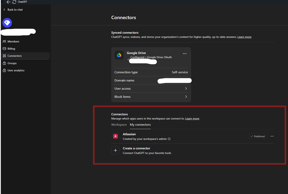

Jose Mendioroz
October 7, 2025
Im not an owner, Im an admin on Business plan, I went to 'Workspace settings, and 'Published' the connector to my workspace hoping this would fix the issue of the toggle being grayed out:
But it still showing grayed out:

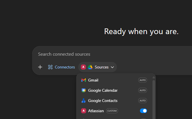

Alexander Corradini
October 7, 2025
Thanks Jose! That was it for me: I needed to publish the connector. Now I can use the Atlassian connector in prompts.
Jose Mendioroz
October 7, 2025
Yeah! After login out and then back in, I was able to enable the connector
