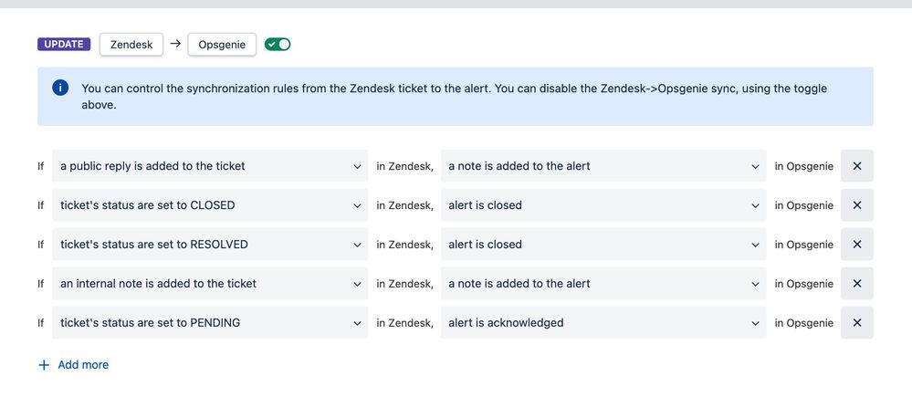

Within the Opsgenie integration, you can configure what will happen to the alert when these triggers/actions are taken on the Zendesk ticket, and how it will map to the Opsgenie alert:

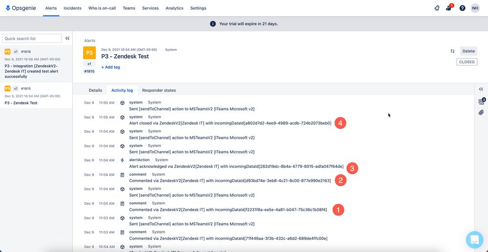

If configured correctly on the Zendesk side, this should work as expected with actions taken on the ZD ticket reflecting on the OG alert:

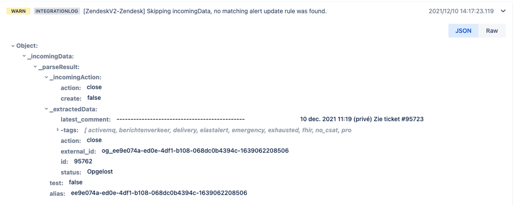

But unfortunately, after fixing the target it still doesn't work, when I update a ticket in Zendesk I see this warning in the OpsGenie logs:

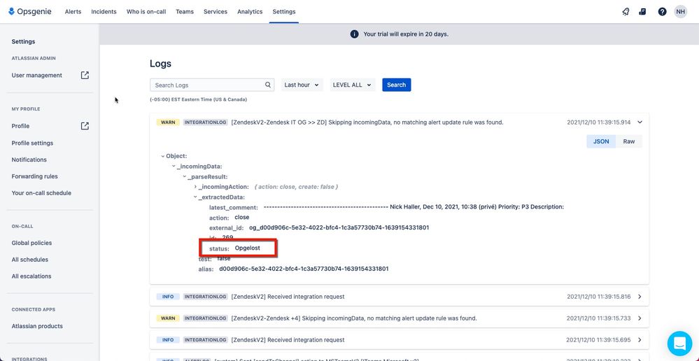

After testing, I believe the language might be the issue. I was able to change my ZD test instances language from English >> Dutch, and ran into the same error.

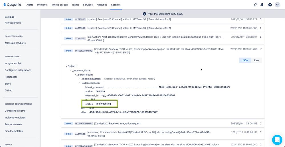

Transitioning the Zendesk ticket to Pending did move the Opsgenie alert to an Ack'd state as expected:
But transitioning the Zendesk ticket to Closed did not close the Opsgenie alert, and gave me the same response error:

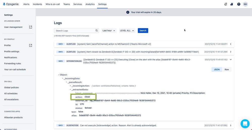

While with a second test, English had no issue:
So I believe this might be a limitation with the language at this time. I'll have to enter a ticket with engineering.
