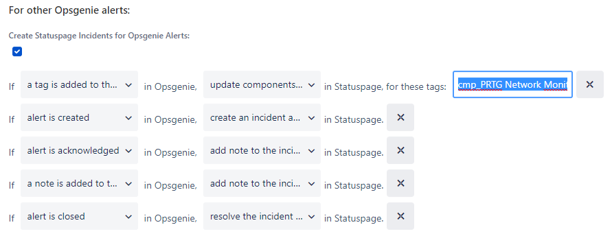

Thank you for your reply. I have tried to set this up using tags but it does not work. As shown below. The these tags part is this: cmp_PRTG Network Monitor:major_outage
and PRGT Network Monitor is the name of the component in statuspage
I would like to add that we want to use this integration only from Opsgenie to statuspage because in the documentation the first line in the screenshot is used in the Send Alert Updates Back to Statuspage part of the integration. We want to send all our alerts to Opsgenie and go from there.

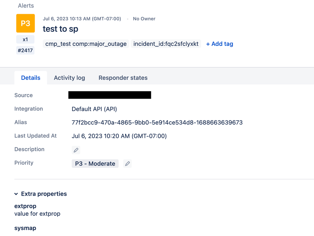

The component tags will only work on alerts that are already linked to Statuspage incidents. When you create an alert, it will send the 'create incident' action to SP and SP will reply back with an incident ID, which will display as a tag on the alert. If that tag displaying the incident ID is not present, that means the alert is not linked to SP and cannot send update actions.
If you are trying to add the tags when the alert is created (not adding them after the alert has been created) you will need to use the "create an incident AND update the comments according to tags" action instead of the "update according to tags" action.

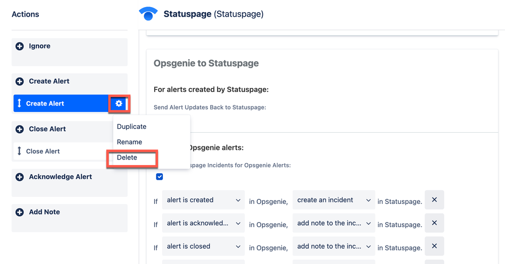

If you don't want to send any actions from SP to Opsgenie, you can simply delete the 'create' actions:
