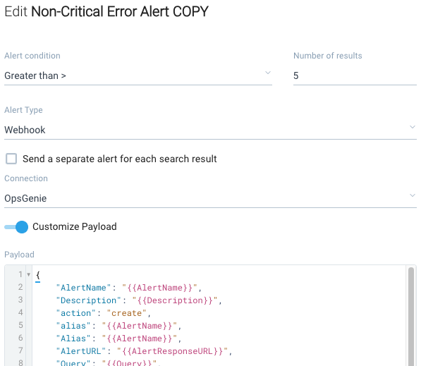

@John M Thanks for the response but that doesn't seem to be working for me.
I've set "alias" as you recommended:

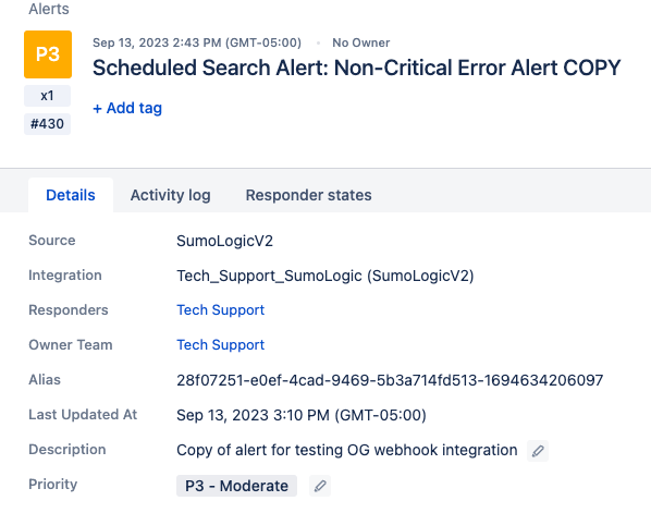

But in OpsGenie, the alias does not appear to be set - it's still random:
and I'm getting lots of duplicated alerts created:

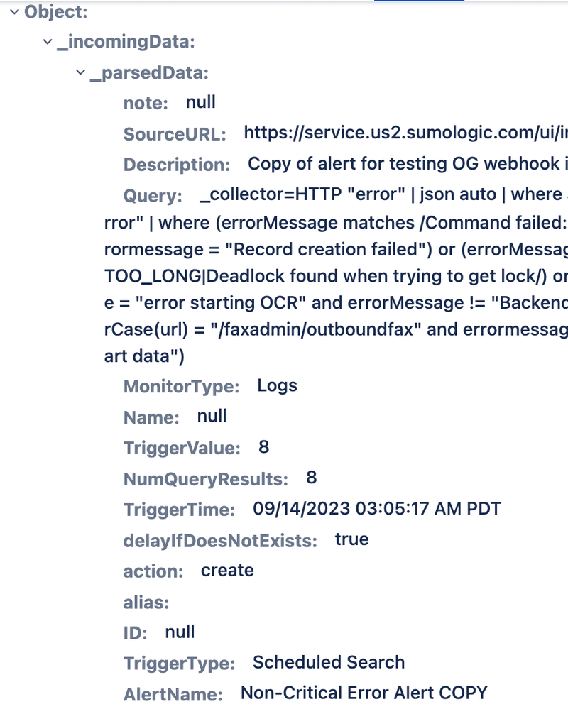

Thanks, John.   I tried your suggestion and replaced `alias` with a constant field and it's still not working.
Curiously, when I look in the integration log in OG, it shows that field as blank suggesting that no data is coming in:

Your screenshot shows the parsed version of the payload, however, the debug logs will show separate entries for both the incoming, unprocessed payload, as well at the parsed payload. By viewing the incoming raw data payload, you should be able to see what was received by Opsgenie and that should help you determine why the alias was parsed to an empty string.
Benj Kamm
September 15, 2023
Thanks for the tip to find the separate logs for the incoming data vs. the parsed data.  That's been helpful and I think it isolates the issue to SL's side so I'll follow up with them.
