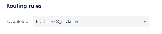

....without a routing rule, correct?
Dave Durand
April 13, 2022

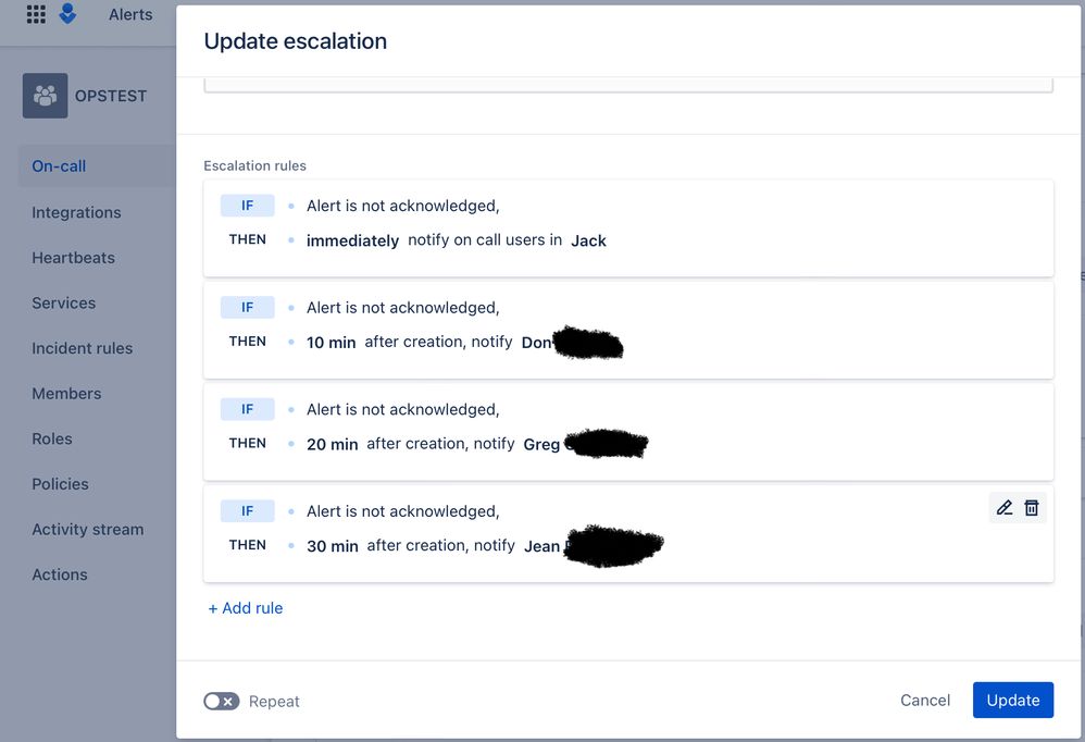

This is exactly how it is set up and the escalation is not working...only the first alert goes out and when the first user intentionally ignores it, it stops there.
Chris Thomas
April 13, 2022
This happens when the Routing rules point to the schedule and not the escalation.
Like Jack Brickey likes this
Dave Durand
April 13, 2022
funny I caught it just before you posted this.  I have to test it but the initial route was only pointed to the primary on-call....DOH!!!
