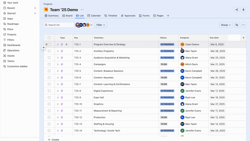

The team started by creating Epics as the highest level items. These mapped either to entire workstreams, or for workstreams with a lot of volume, to larger buckets of work within them. For example, Content was one of the largest so it was divided into:
  • Content: Breakout Sessions
  • Content: Founder Keynote
  • Content: Learning & Certifications
and so on. The easiest rule to follow when it came to determining epics was that each one had to be led by a single workstream champion (who does not necessarily own all of the tasks within that workstream).

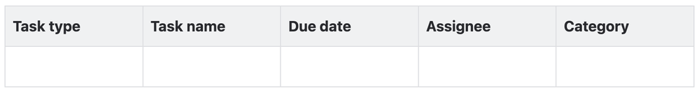

Once workstream owners were on board, inputting each one of their hundreds of tasks manually wouldn’t make sense, so Sherilyn and team provided a template:
They could then take these lists and use the bulk import function to get over 1000 tasks into Jira, which saved a considerable amount of time and effort.

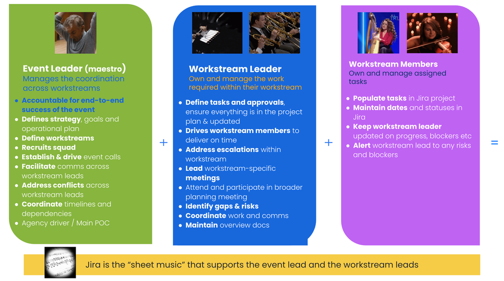

With everything imported and visualized in Jira, Sherilyn and Kelsey were ready to show the team the ropes. But before jumping right into hands-on training, it was critical to introduce everyone to the central operating model so they could see the whole picture.
This presentation made a lasting impression on the team because it was fun, engaging, and creative. Sherilyn and Kelsey used metaphors from orchestras to dream houses to make this new way of working approachable and clear.
The key takeaway about Jira: it was one of several key tools like Confluence, Slack, and Zoom that would help the team make the most impact — each in a clearly defined, differentiated way.
Now for the Jira training. It focused on creating and viewing tasks within the hierarchy, filters, and views. The goal was to provide knowledge and flexibility so that each team member could customize however they prefer, and to highlight its integrations with already well loved tools like Slack. Sherilyn and Kelsey also provided in-depth guides on Confluence and bite-sized training through Loom going over one feature at a time.

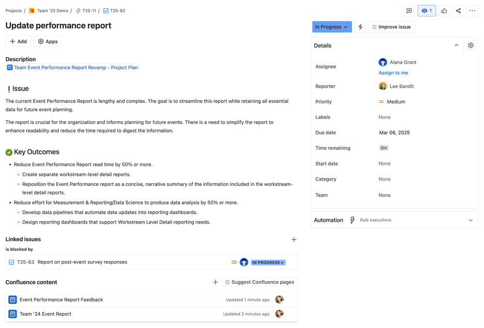

To prevent information from slipping through the cracks, the team took full advantage of detailed task views to provide context and cross-link as much as possible.
  • Task descriptions: What is this task? Who are the key players? What are the key things team members need to know? What Confluence pages should they read to learn even more?
  • Linked work: What tasks are related to this one, whether it’s more of an FYI or a dependent relationship?
  • Attachments: What are the key resources that are relevant to this task?
  • Comments: Async questions and updates between team members should happen on the task itself instead of in multiple other channels
