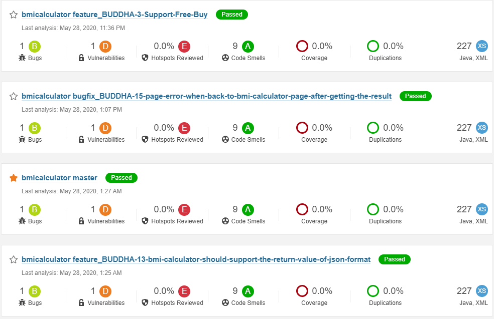

My resolution is as follows:
In the task of Sonar Maven 3 of Bamboo CI, configure "Replacement for illegal branch characters" as "-". This config is for replace the / in the branch name like "feature/xxxx" to "feature-xxxx". (You could see the screenshot for Sonarqube project name.)
Sonar only allows alphanumeric, "-", "_" and "." characters in its project keys. Therefore, a "/" which is typically used in Git branch naming patterns (e.g., features/user-story-xyz) must be replaced by the provided character here. The default "_" is fine when you use Sonar for Bitbucket Server or Jenkins.
