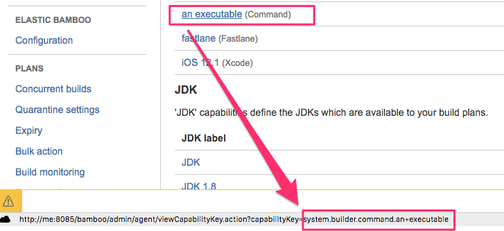

You need to use the full capability key to make it work.
When the requirement is configured through the UI, even though there is just a name there, it has the right key loaded in the background (DB). When using this type of configuration in specs you need to provide the right key.
I'll open a request to improve this feature so you don't need to use the full key name to make it work. [BAM-20322] Setting a requirement in YAML specs leads to no agent can build this job.
This is how you get the full key:
Please let me know if you have questions on this.
