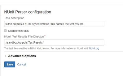

Ok I have two possible routes for you.  If you are using the MSTest Parser, you might be running into the same issue as reported here:
https://community.atlassian.com/t5/Bamboo-questions/MSTest-unable-to-parse-results/qaq-p/308991
I took a look at my own environment and realized that we aren't acutually using the MSTest Parser task.  I'm using the NUnit Parser task who's configuration looks like this:
I hope one of those two options helps you resolve your issue.
