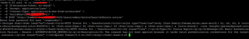

I want to delete multiple plans from my server .
can any one suggest me how i can follow the steps.

@SunadhRaj.Malaka As from screenshot, you are getting 401 error. Please check if credentials are fine or also, please check below:
  1. Confirm the URL Is Correct. This might sound obvious, but the 401 error code might appear if the user entered the wrong URL in the browser's address bar.
  2. Clear User End Issues.
  3. Check Authentication Credentials.
  4. Disable Password Protection.
  5. Troubleshoot the Code.
You can also follow this doc : https://confluence.atlassian.com/bamkb/how-to-delete-bamboo-projects-and-plans-in-bulk-using-rest-api-1216583450.html
You be honest, I am not sure about Rest API's. Might be above solutions will help you or you can also raise the ticket with Atlassian via https://support.atlassian.com/

i want to delete from REST API , i am trying with this below rest api  and facing some the issue attached can you guide me on this .
REET API
# Marks plan for deletion. Plan will be deleted by batch job.
# replace {username}
# replace {planKey}, e.g PROJ-PLAN
# replace http://localhost:8085 with URL to access Bamboo
curl -k -u {username} \
-H 'X-Atlassian-Token: no-check' \
-H 'Accept: application/json' \
-H 'Content-Type: application/x-www-form-urlencoded' \
-d 'buildKey={planKey}' \
-X POST 'http://localhost:8085/chain/admin/deleteChain!doDelete.action'2
