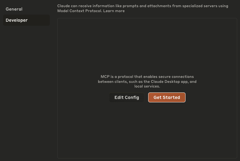

Take Claude Desktop as an example, you can find its MCP configuration file from the "Developer" tab in its settings dialog.
To setup connection to the Atlassian Remote MCP Server beta, you can use the following configuration -

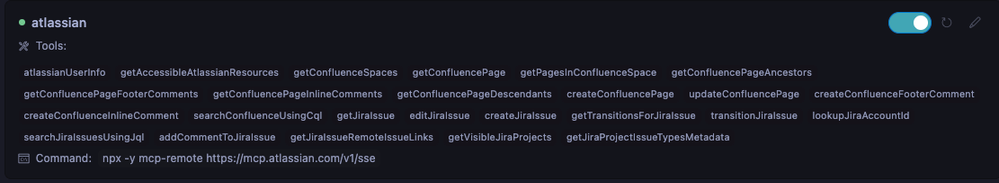

Alexander Gertz
May 15, 2025
@Jay KelnerThanks for your replys.
For anyone wondering how to set it up in Cursor:
you should install mcp-remote with
npm install -g mcp-remote
Also make sure to use a newer version of Node.
Then you can run the command below to trigger the authentication if thats not happening when you try to use the MCP in your IDE.
npx -y mcp-remote https://mcp.atlassian.com/v1/sse
After that you should be able to reload the MCP in Cursor and see the available tools:
Turns out after that I can not use any of these tools in Cursor and the MCP logs does not show exactly what is wrong:
2025-05-15 11:47:14.413 [error] user-atlassian: [50052] [Local→Remote] tools/list
2025-05-15 11:47:14.580 [error] user-atlassian: [50052] [Remote→Local] 1
Nothing shows in the MCP logs after trying to use the Atlassian tools.

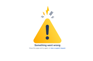

Song Huang
May 21, 2025
Got the error after grant the "Altassian MCP" app, what's the reason, permission issue?
UPDATE on 23 May:
Tried with an admin account, and get the error as well. May be it's due to the app also request confluence view/update permission, however, I'm only using Jira now.

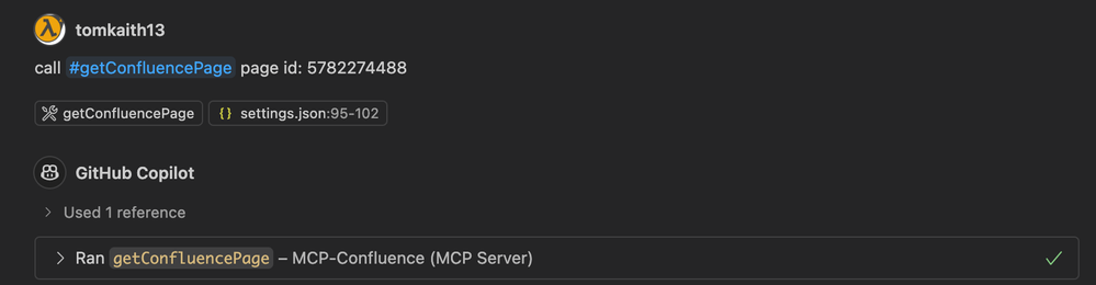

I'm seeing the same issue others are seeing when trying to use this MCP server in VS Code. When I issue a general query I see the following error:
Failed to validate tool bb7_transitionJiraIssue: Error: tool parameters array type must have items
And, when I issue a query like: "call #getConfluencePage 12345" as shown in other comments above, the input is:
"cloudId": "your-cloud-id",
"pageId": "12345"
and the error I see is:
{"error":true,"message":"Cloud id: your-cloud-id isn't explicitly granted by the user."}
It looks like the cloudId is not being set correctly for my MCP server requests. Should this cloudId be set as a part of the mcp-remote operation that performs authentication? Or is this something I need to set manually in my VS Code config (or elsewhere)?

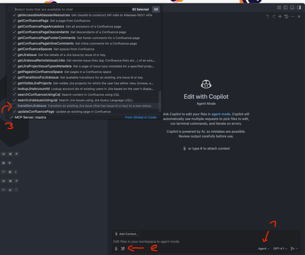

Manuel Göster
May 22, 2025
I resolved the bb7_transitionJiraIssue by disabling only this tools. Then you can use all other MCP tools. Looks like it is malconfigured on the atlassian MCP server side!
To disable it, use the Tool icon in your copilot chat window, find it in the list of tools and deselect it.Screenshot 2025-05-23 at 08.35.10.png
